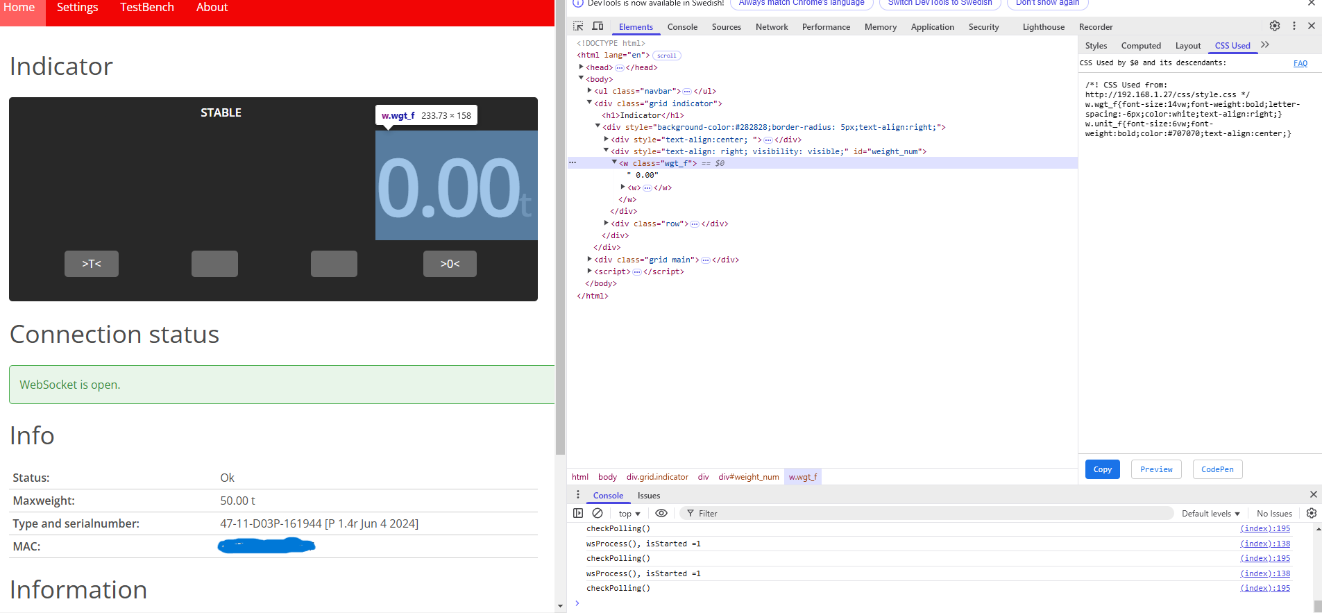

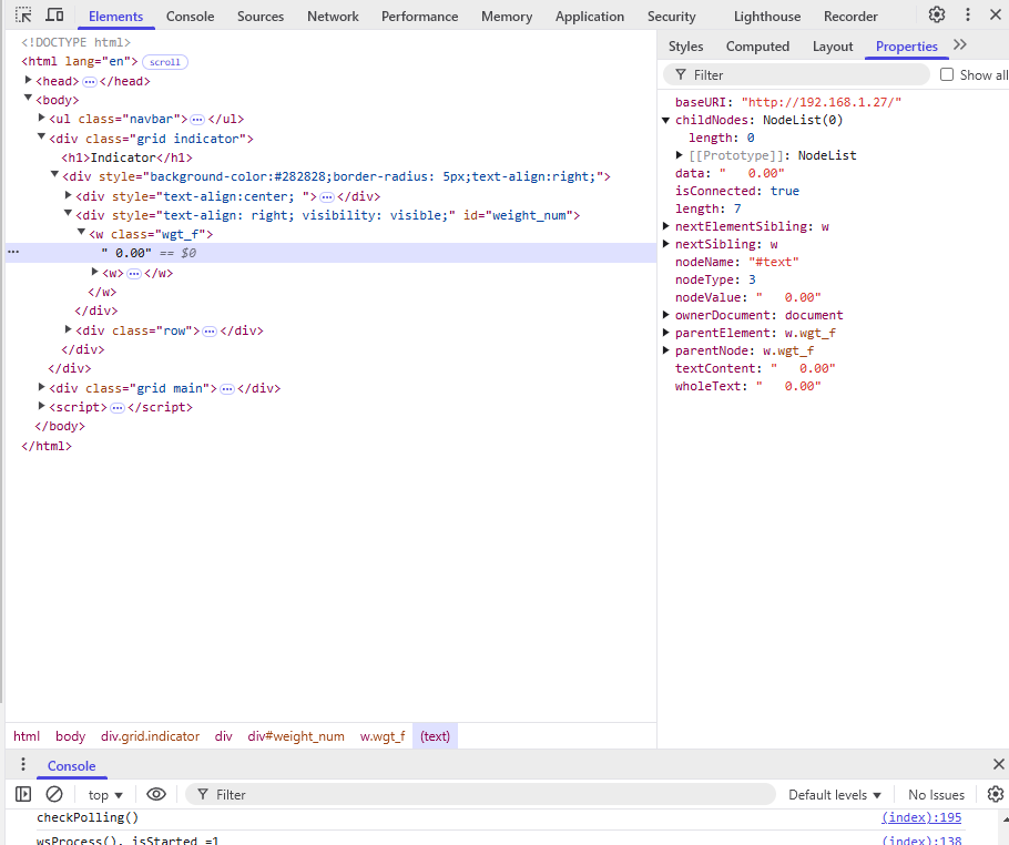

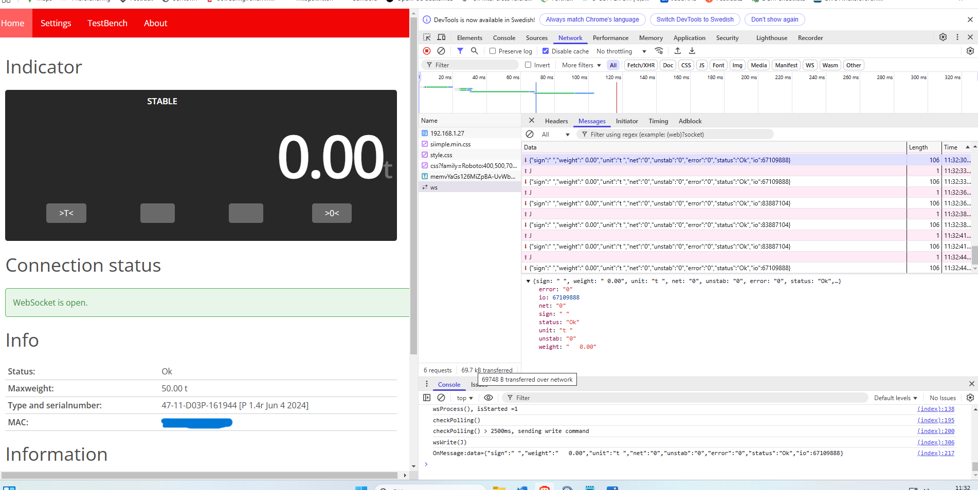

Hello!
First post.
Im a complete noob and i want the value from a weight indicator to show as an overlay in Blue Iris.
I have searched the forums and tried JsonDataExtractor but i dont understand how to make this work.
“This page uses WebSockets. Weight value and status is polled from the indicator in JSON format each 14 second
This is done by opening a websocket to the root address (or ‘/ws’) and writing the command ‘J’ which will
reply with a JSON formatted string containing real time data and status for the indicator
The indicator will normally send any change in weight or status as it happens or an update every 12 second”
Any advice is welcome. Thank you.
Indicator IP is 192.168.1.27 but i cant seem to post its html content here.

It sounds like the device only provides the weight data via a websocket. The JsonDataExtractor app does not support using a websocket to receive data. It requires the JSON payload to be delivered as the response to a simple HTTP request.
You would have to ask the company if the device has a URL that will deliver the JSON payload via plain HTTP without a websocket. If that does not exist already, it would be extremely easy for them to add in a firmware update (assuming the firmware can be updated by the user). If you can get that URL, you can put it into JsonDataExtractor and see the response and work out the correct syntax to pull out just the weight number.
