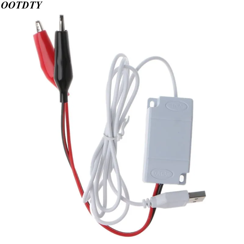

Just need to find a better way of creating a 'battery eliminator'. Those guides seem a little too DIY/amateurish to me :confused:.
Good to know. I have no experience with the battery eliminator shown in the following link, but it looks like the 3V step-down (Plug Type: DC 3V) converter could work. Basically you connect a 5V usb power pack (similar to iphone power supply), to provide 3V at the output terminals (red clip is positive, black clip negative). If installing, remember to remove the CR2 battery, using only the clips with the corresponding polarity. You may contact the alli express store for more information. Good Luck!
note: even thou the 3V plug should be ordered, if you have a voltmeter, it could be a good idea to check the output voltage before connecting. It looks like an internal adjustable voltage is included for fine tuning
