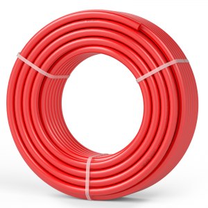

With 3/4" Pex being about half the cost of rigid 3/4" conduit, you better believe I am going to use it if I can. And it's one solid length and water won't get in? Sign me up.The Plumbtrition strikes again!!!

Glad ya'll started talking about this, I got about a hundred foot underground run from our Main House out to a Pool House I want to do. Been thinking of Pex too but we have Voles (Like Moles) and Gophers and whatever else in ground. I have been eyeing this or others like it:With 3/4" Pex being about half the cost of rigid 3/4" conduit, you better believe I am going to use it if I can. And it's one solid length and water won't get in? Sign me up.
For that price you could probably just run armoured Cat 5.Here is 20 foot sections for $10, so $50 for 100 foot, which Pex is around that cost...
