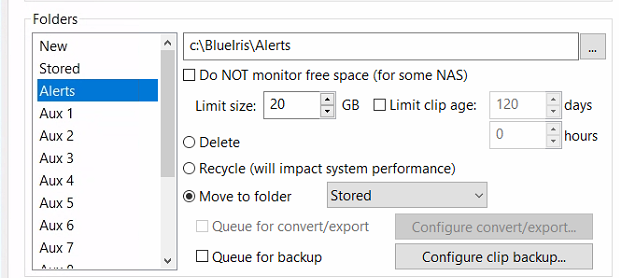

Hi folks, just looking to see if my BI, DB & storage is the best optimization with my set up. I have a OptiPlex 7040 with a Max of 3 Drives, actually has a DVD drive so maybe I could add a 4th.
Current set up
C:\ 240GB SSD C:\Program Files\Blue Iris 5, C:\BlueIris\Alerts (170GB free)
Z:\ 240GB NVMe Z:\BlueIris\db (220GB free)
S:\ 6TB Purple S:\BlueIris\New, S:\BlueIris\Stored (NEW limit size 5000GB, Stored limit size 100GB) 600GB free
Should I move alerts to Z drive?
Should I remove the "BlueIris" parent folder from Z & S drives?
I don't recall why I setup New & Stored size limits that way, Any improvement suggestions welcome.
I am planning on 6 or 7 cameras so on a 6TB drive that's probably only 20 days storage. Could I move the Stored to a external drive later down the track or just get a bigger purple drive?
Goal would be a comfortable 30 days storage but 20 days is fine for now..

Don't use STORED - you are just burning CPU and the drive moving stuff around on the same drive. Only use it for external to the box like a NAS. So set STORED to 0.
I would put BI and the DB on the same drive.
Alerts could go on the Purple drive.

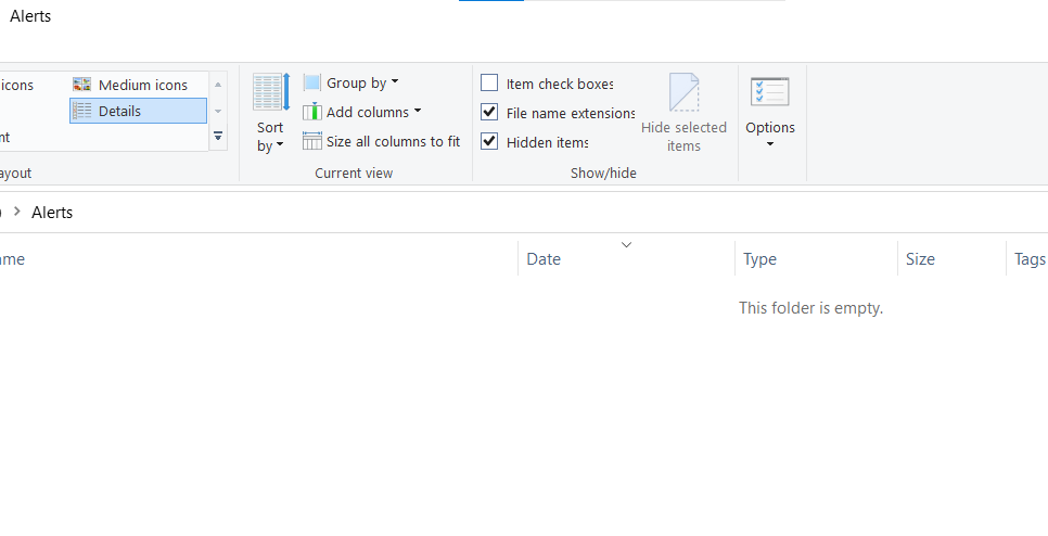

The alerts folder is a weird one - it holds all the thumbnails yet you don't see the files, even if you turn on to see hidden files - unless you are saving as hi-rez or burning AI images. So if you were to make that 0GB all your thumbnails for the triggers will disappear.
If you are not going to do AI or hi rez alerts, then make the limit size 1GB as that is more than enough. And then tell it to delete instead of Stored.
But if you are going to do BI AI and save the .dat files, then you will want the Alerts folder to be a decent size.

The alerts folder is a weird one - it holds all the thumbnails yet you don't see the files, even if you turn on to see hidden files.
Do you mean in Windows or talking about something else? I can see mine. I know because I have a gazillion of them and clean it out now and then.
wittaj
Apr 28, 2019
25,147
49,019
Are you saving hi-rez or AI burn in photos? Those you can see, it are the thumbnails for all the triggers that you don't see.
But if you aren't doing anything fancy and just have triggers do database only, then the thumbnails don't show in Windows.
I have 45 days of alert thumbnails for the triggers in BI yet my alerts folder is empty, even with it showing hidden files:
If I delete this folder or change the Alerts to 0GB then those 45 days of thumbnail alerts disappear.

Ahhh... gotcha. Yes, I have .jpgs being saved for my LPR cams and a couple of others. That's what's in there.
The thumbnails must be saved somewhere else or otherwise derived from the video. BI can't hide files in some way from Windows' native view.

Sweet, I'm not doing anything clever with hi rez alerts or AI as yet, so good to know this is normal.

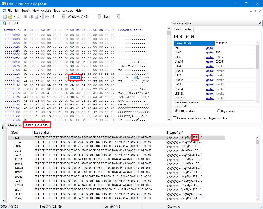

It’s always been my understanding that the thumbnail images are stored in the database itself.
To check this, I just opened the clips.dat file in a hex editor and searched for the JFIF Start of Image (SOI) marker (bytes FF D8).
REF: Per the JPEG File Interchange Format (JFIF)... any JPEG file or stream is written according to the JFIF must start with a SOI (Start-of-Image) marker (the two bytes 0xFF, 0xD8) and end with the EOI (End-of-Image) marker (two bytes, 0xFF, 0xD9). These two markers will not be found anywhere else in a JPEG file/stream.​
Sure enough, there were thousands of hits.

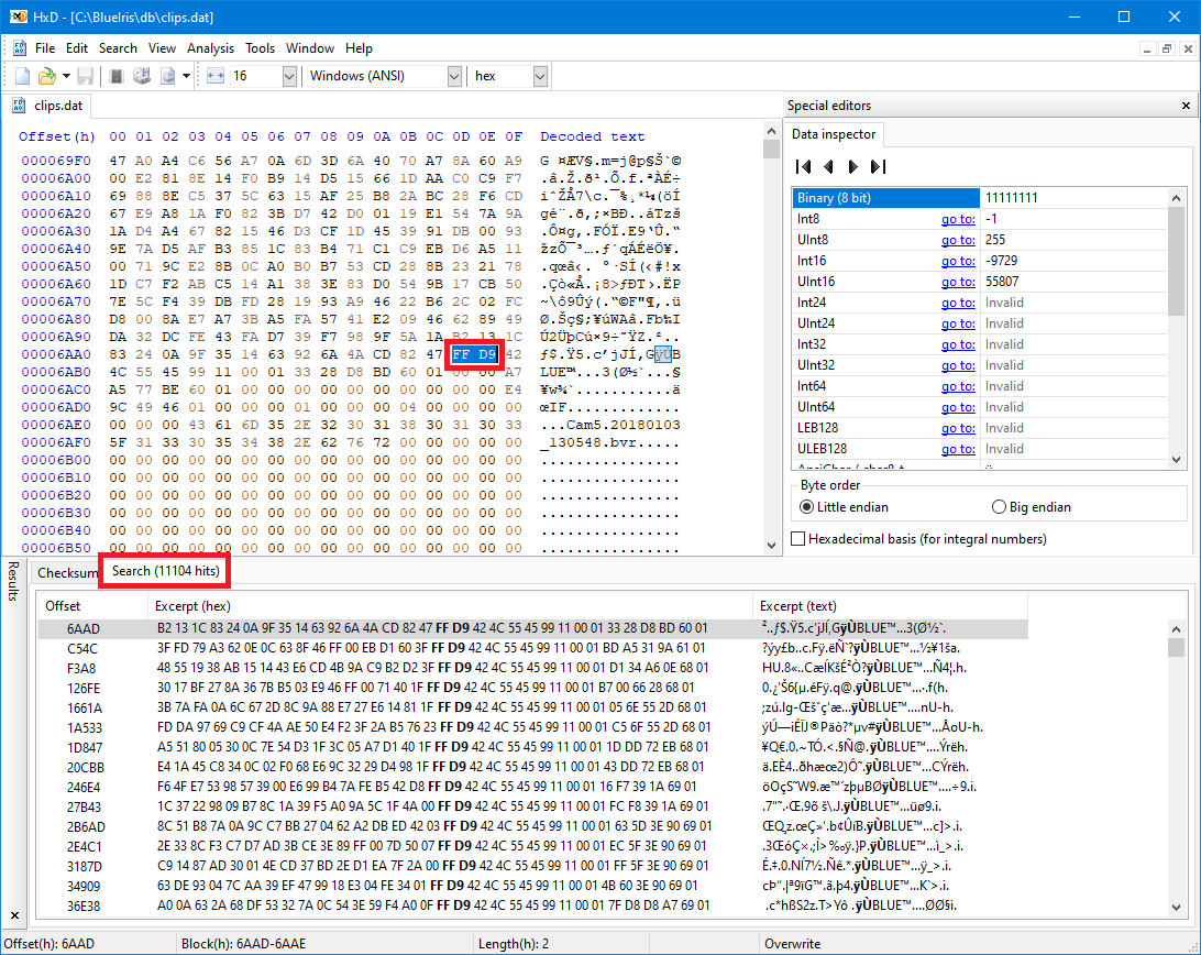

I also searched for JFIF End of Image (EOI) bytes (FF D9).
I was expecting the result to be a matching number of hits. But the number was fewer (11,104 vs 13,598). I've no idea why this might be the case. I scanned through the SOI marker results and did not see any that were NOT followed the 'JFIF' bytes. So I don't think the search found any SOI markers that were not part of a JPG file.

Yeah, I looked a little more last night and tried deleting various files and seeing the effect and that's what I ended up thinking. I didn't try deleting that file (for obvious reasons), but you can delete pretty much any others associated with that cam/clip (.bvr, .dat for that cam, etc.) and the thumbnail remains. Didn't seem to be any other place that it could be stored.
