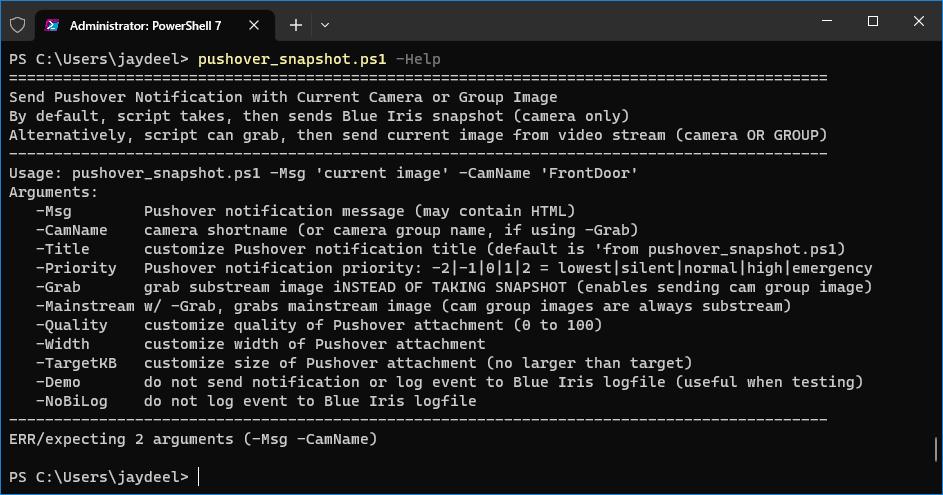

Here's a screenshot of all arguments available in the script:
pushover_snapshot.ps1 -Help

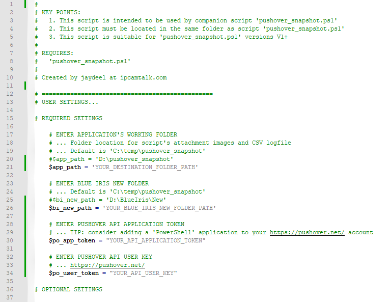

Edit the user settings file
- The user settings file is named 'pushover_snapshot_user_settings.ps1'?
- Open the file in a code text editor (I use Notepad++)
- Edit the REQUIRED variables in the USER SETTINGS section (see screenshot)
- Ignore the remaining settings for now. They provide customizations that you may want to explore later.

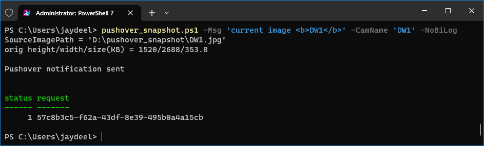

Test the script from the console
- Open an Admin PowerShell window, or Powershell-ISE window
- Select and copy each of the the following commands and paste it into the console (one at a time)
pushover_snapshot.ps1 -Msg "current snapshot" -CamName "DW1"
pushover_snapshot.ps1 -Msg "current stream grab" -CamName "DW1" -Grab -Mainstream
pushover_snapshot.ps1 -Msg "current stream grab" -CamName "Index" -Grab
- Edit 'DW1' to match the short name of one of your cameras
- Hit the Enter key.
The response should look like following screenshot

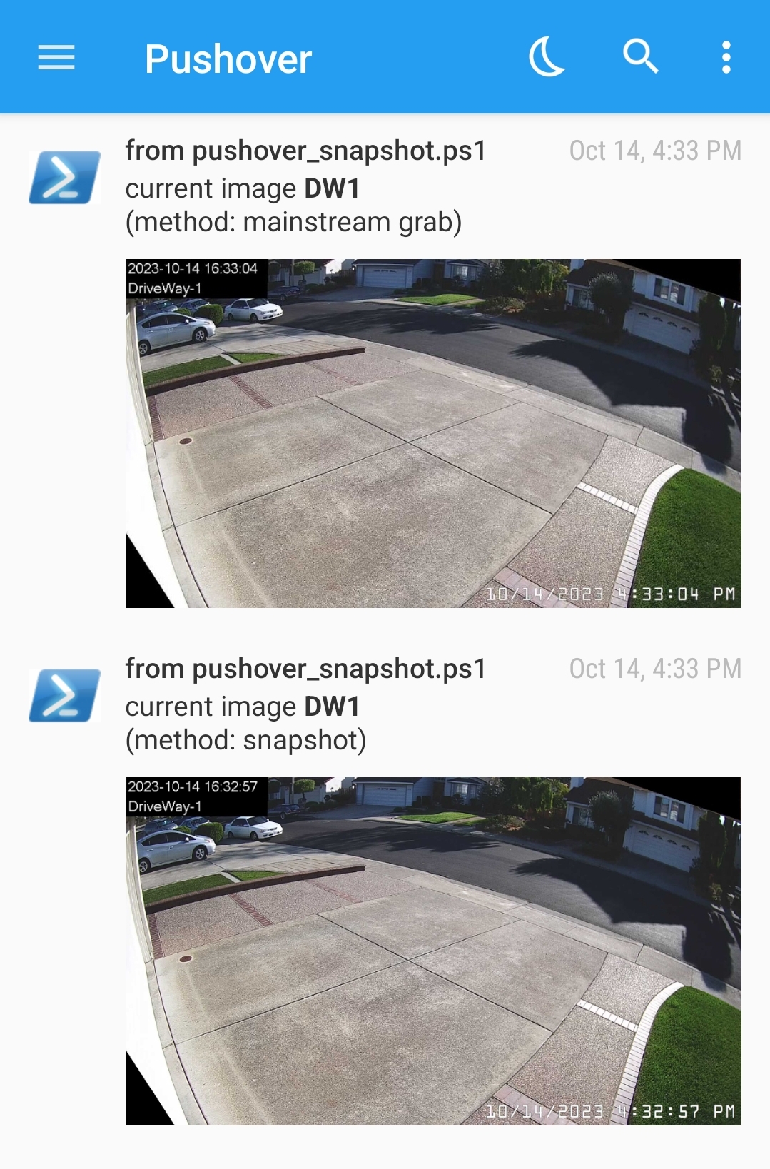

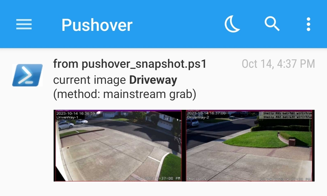

You should also receive your first Pushover notifications from the script, like these examples:

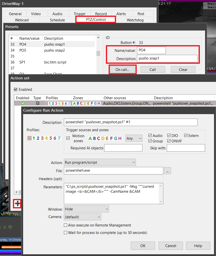

Test on a on a camera Preset
- Click 'Camera settings' > 'PTZ/Control' tab
- Click 'Edit Presets..." to open the preset editor

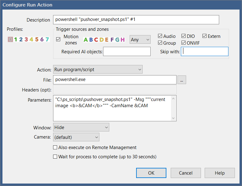

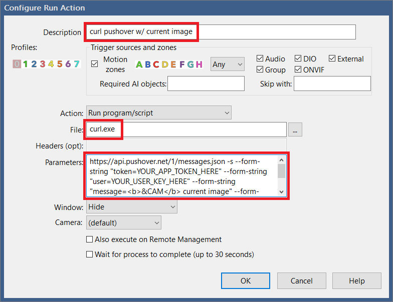

- Create a new 'Run a program' action, and configure it as shown in the following screenshot
The code for the 'Parameters' field is like the following:
"C:\ps_scripts\pushover_snapshot.ps1" -Msg """current image <b>&CAM</b>""" -CamName &CAM
"C:\ps_scripts\pushover_snapshot.ps1" -Msg """current image <b>&CAM</b>""" -CamName &CAM -Grab -Mainstream
Please note that the triple double quotes (""") in the -Msg parameter are ESSENTIAL.
