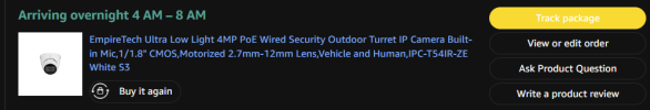

I just pulled the trigger on the EmpireTech IPC-T54IR-ZE-S3 1/1.8 ( Here comes the justification for my wants LOL)

WTF Amazon. Why are they defaulting to a 4AM-8AM overnight delivery? it's 2:25 Am now....LOL Should I make coffee and sit out on the porch? :)
