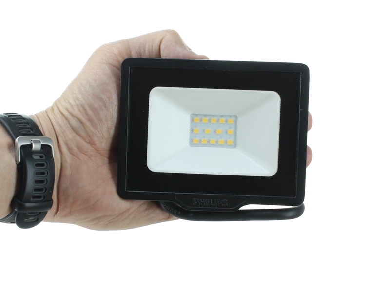

Follow Sebastian's recommendation of a 10W led flood light (note go for 6500k colour temp - with many lights that will give you a white close to daylight look. 4000k or lower will give a pronounced yellow colour cast, Although some claim daylight at 4500K, I've yet to believe it. To my eyes, most of these lights look neutral around a claimed 6000-6500K. Even within the industry there seems to be confusion about Daylight with claims ranging from 4500-6500K. My recommendation is go high. (I've tried plenty of lights / headlight bulbs at 4500-500K and they still look yellow).
10W floodlights are exceptionally small and so it won't be obtrusive. I'd personally conside mounting one on the apex of the shed roof pointing almost straight down. You can always put a hood on your camera if there's any direct glare however, with the camera pointing downwards and the light pointing straight down, it's unlikely to be a major issue. Be aware that at roof height, your camera is unlikely to capture a facial shot. Hoods for turrets can be bought on Amazon for less than £10 from memory.
For neatness you could go with an all in one light and pir. You save electricity and be green, and give the light a longer life using a PIR. Personally I prefer to keep them separate as then I can switch out the light or pir at will saving the cost of buying both. These days with the good cameras they adapt almost instantly to change in lighting. PIR's fail eventually and light needs might change or your light may simply fail. Either way, it can work out cheaper and more flexible to have them separate as then you can exchange pirs and up grade / down grade / replace lights at will.
This google picture shows how small the 10W ones are:
