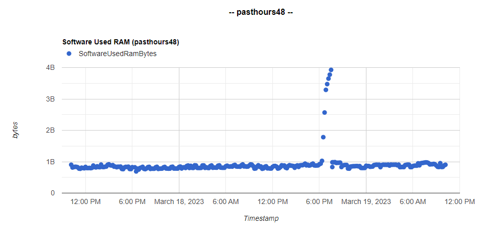

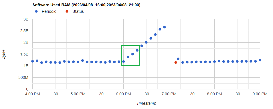

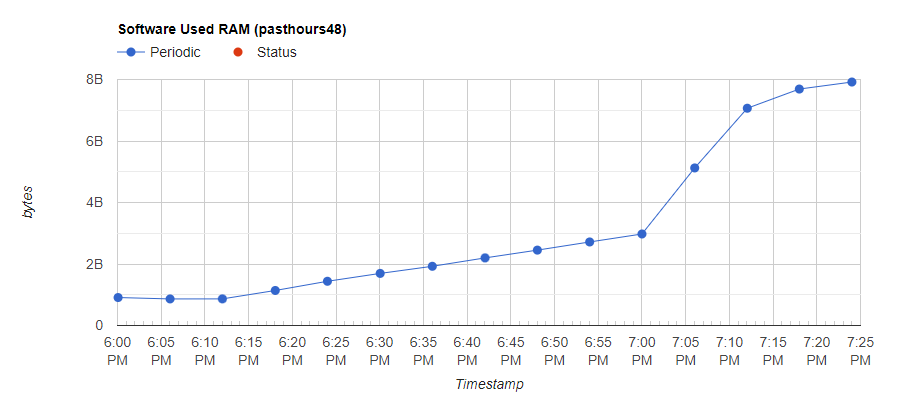

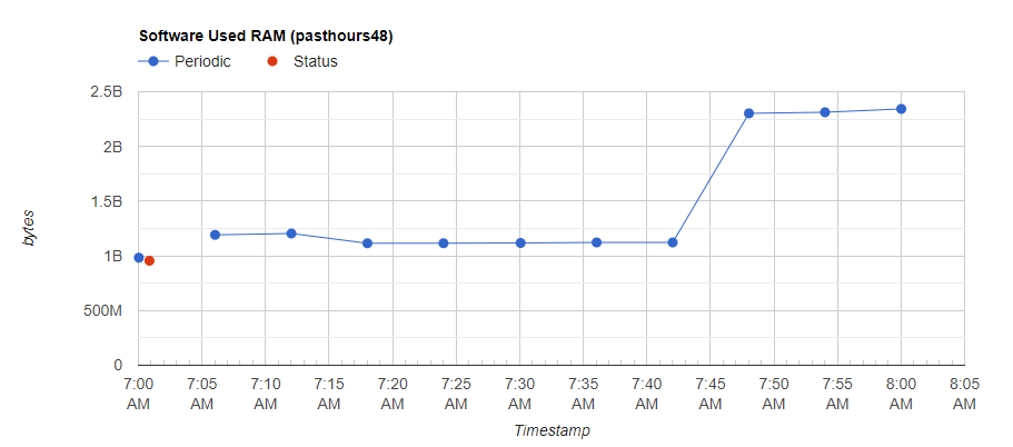

The following screenshots illustrate two types of leaks detected:
'Continuous' type memory leaks...
'Step' type memory leaks...

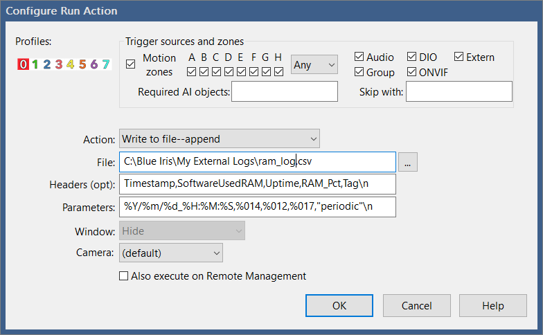

'Write-to-a-file' actions
Required...

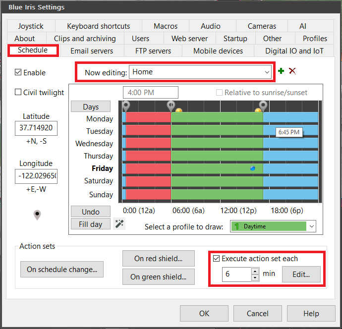

1. Click Blue Iris Settings > Schedule > 'Execute action set each N min' > 'Edit' button
2. Add actions per the next screenshot, and the Key Point below...
You can copy/paste the following into the respective fields:
Header field: Timestamp,SoftwareUsedRAM,Uptime,RAM_Pct,Tag\n
Parameters field: %Y/%m/%d_%H:%M:%S,%014,%012,%017,"periodic"\n
Key point: Schedule tab action sets are Schedule-specific.
You must repeat steps 1&2 for each Schedule you use (via the 'Now editing' control).

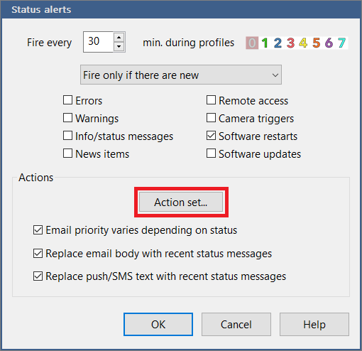

This additional action will add entries to the CSV file when the Blue Iris service is restarted.
These entries can be helpful when inspecting the data after a memory leak event.

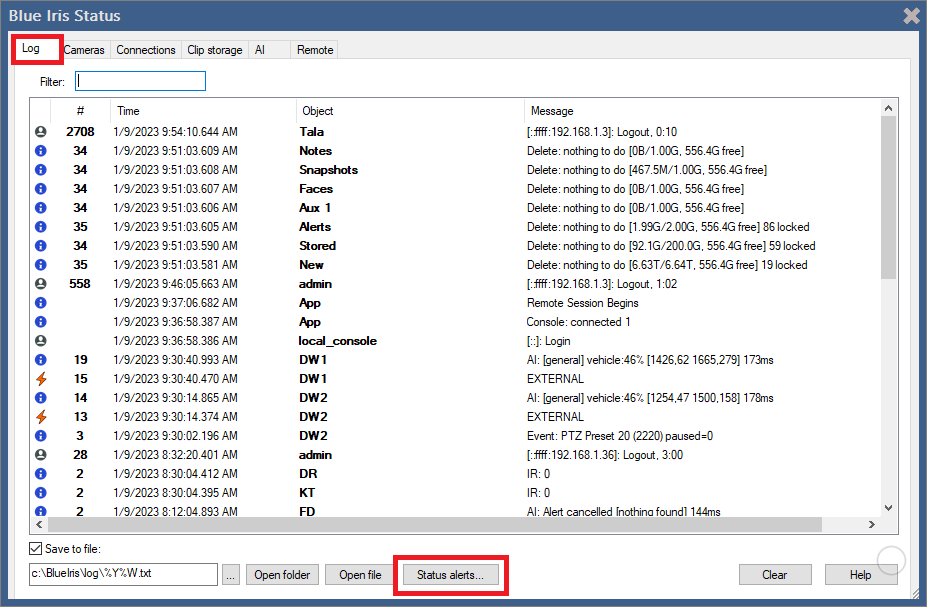

1. Click the status icon (chart).
2. Select the 'Log' tab.
3. Click the 'Status Alerts...' button.
4. Click the 'Action set' button
5. Repeat Step 2 in the Required section above, replacing the Parameters field with %Y/%m/%d_%H:%M:%S,%014,%012,%017,"status_action"\n

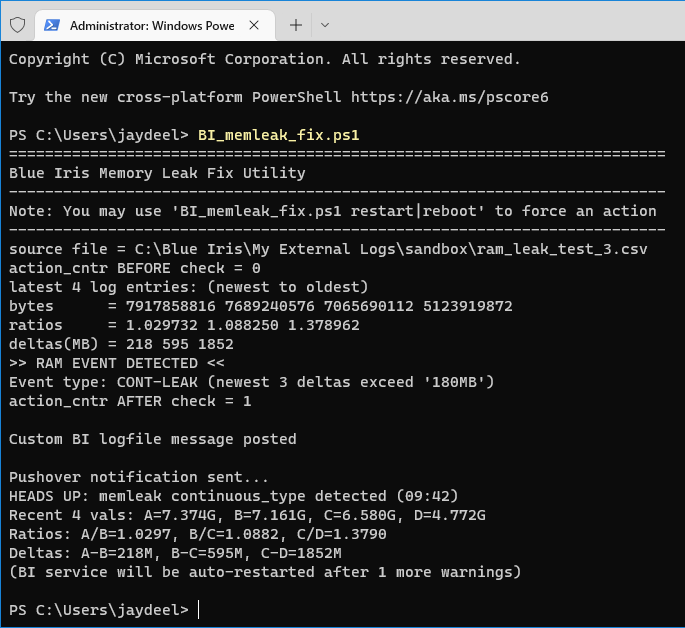

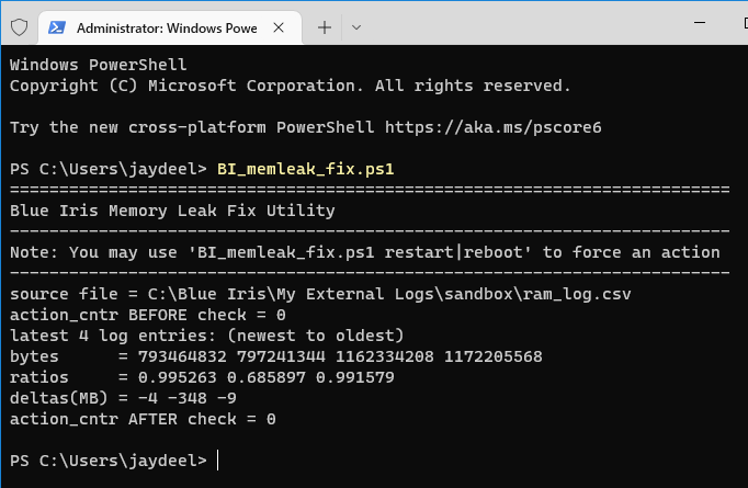

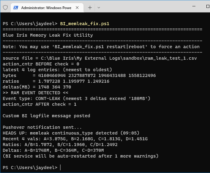

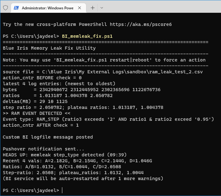

The following screenshots illustrate the script's output (in a PowerShell window) using the extra *.csv files in the *.zip file.
1. No event detected.
2. 'Continuous' type leak event detected.
3. 'Step' type leak event detected.
4. 'Continuous' type leak event detected (2nd example).
5. Same as #4, triggering a Blue Iris service restart.
output_demo_0.png output_demo_1.png output_demo_2.png output_demo_3.png output_demo_3 w restart.png

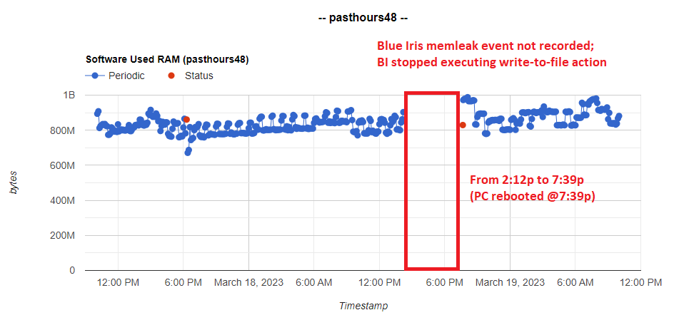

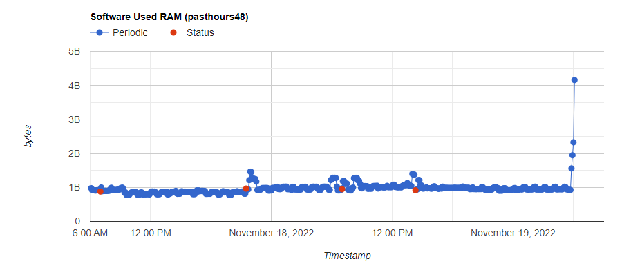

Yesterday I experienced a memory leak event that defied the methodology described in the 1st post above.
What happened was this... Blue Iris stopped executing Action set actions during the leak event.
Thus the Blue Iris write-to-file action CSV file being used by the PowerShell script was not being updated during the event.
Below is a chart of the write-to-file action memory usage data before, during and after the memory leak event.
Note the lack of data during the timespan enclosed by the red rectangle.
I only discovered this because I use a redundant method to log memory usage.
This data clearly shows the memory leak event.

The provided test examples include an image illustrating the data points (green box) that trigger a memleak event by the script. Every test *.csv is from an actual event.
Example:

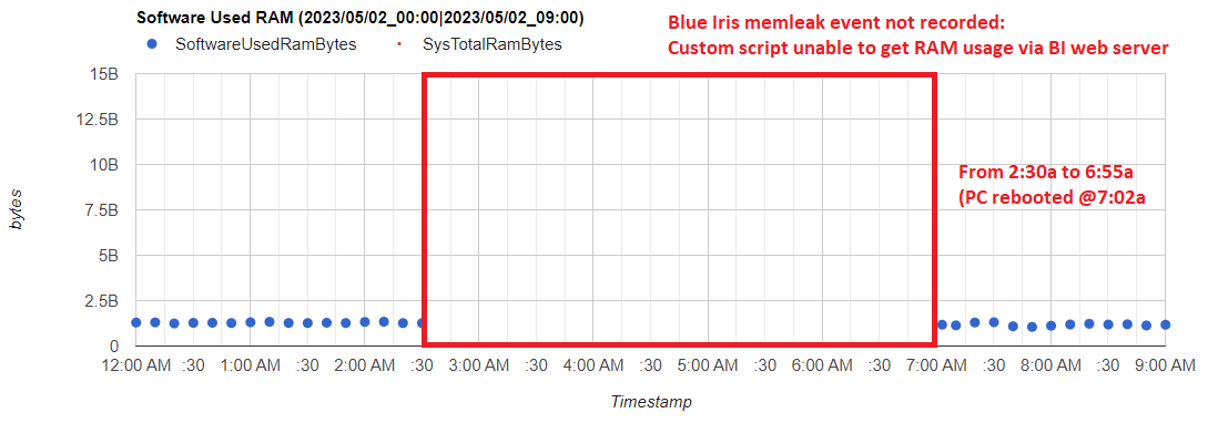

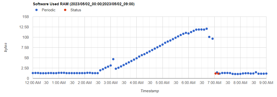

Early this morning I experienced a memory leak event that flipped my observation for the event in post #2 above.
What happened was this... the redundant CSV log file being updated by Blue Iris JSON interface requests stopped being updated during the leak event.
On the other hand, the original CSV log file being updated by Blue Iris write-to-file actions continued to be updated during the event.
Compare this to the 1st chart in post #2 above.
This next screenshot shows the memory usage data collected via the Blue Iris web server JSON interface.
Note the lack of data during the timespan enclosed by the red rectangle, which spans the memleak event in the above chart.
Conclusion: To successfully detect a Blue Iris memory leak event, it appears that I need to use two scheduled tasks running the PowerShell BI_memleak_fix.ps1 script.
  1. One reading the CSV file being updated via Blue Iris Action Set actions.
  2. The other reading the CSV file being updated via Blue Iris JSON interface requests.
