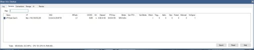

I have the IPC-B52IR-Z12E S2 camera and purchased the BI5-Full and installed CPAI 2.9.5 (LPR 3.3.4 - see attached). HW is i7-7700K and NVidia P600. Plenty of SSD
Watched "The Hook Up" video three times and went thru the setup per that video. The UI for BI and the camera have both changed since that video was posted a year ago so there is some confusion. I have reviewed many articles in this forum and BI Forum without success. Going on 10 hours now over two days and I am looking for some direction to get this specific combo working for Day/Night LPR capture, not to become an expert. BI Status shows blank AI tab. Also there are about 4 or 5 random recordings, probably during settings changes following along the video tutorial. Interestingly, the BI Camera AI settings/Static Object analysis recognizes DayPlates and vehicles (see attached)
Added screenshots for clarity of current setup. I didn't insert all the CamUI Image pages but those match all from the tutorial video by The Hook Up. Also, the BI Web Server, Schedule, and Location tabs all match the video recommendations. Any guidance would be greatly appreciated.

You can enable ONVIF/ camera events and disable Motion from BI.
The IVS rules inside the camera will sense more precisely the IVS motion trigger rules.
I'm just experimenting with IVS the last couple of weeks and I getting less false triggers. thanks to @wittaj.
You might have too many variables going with BI Motion, Codepreject motion, and internal Camera motion.
Sometimes the distance is short enough to use the Z4e version of this bullet cam.
I find it less picky than a Zoomed Z12 in a location like you can see in one of your uploads.
