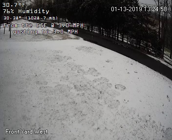

I ran the upgrade and that's a good solution, Mike. Makes me happy, anyway, if that counts. Thanks for the work you put into this!
Here's the image I'm using on WU, very downgraded video from a 4231E-S...

Glad to hear. You can also remove everything after the comma and/or put it in its own textbox if you want.
