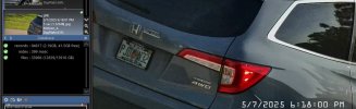

I think I might have some user error or misunderstanding on my part. When I use your provided test, It reads it just fine both cpu and gpu. I had blue iris set to zoom on object. Removing that seems to have fixed my issue. My neighbor has a visitor that is parking right in my shot since yesterday so it's not an ideal situation for me. But I did just get a plate read and in the BI log I now see the plate. But if I take this image and run it through the Codeai explorer it doesn't read it at all.
