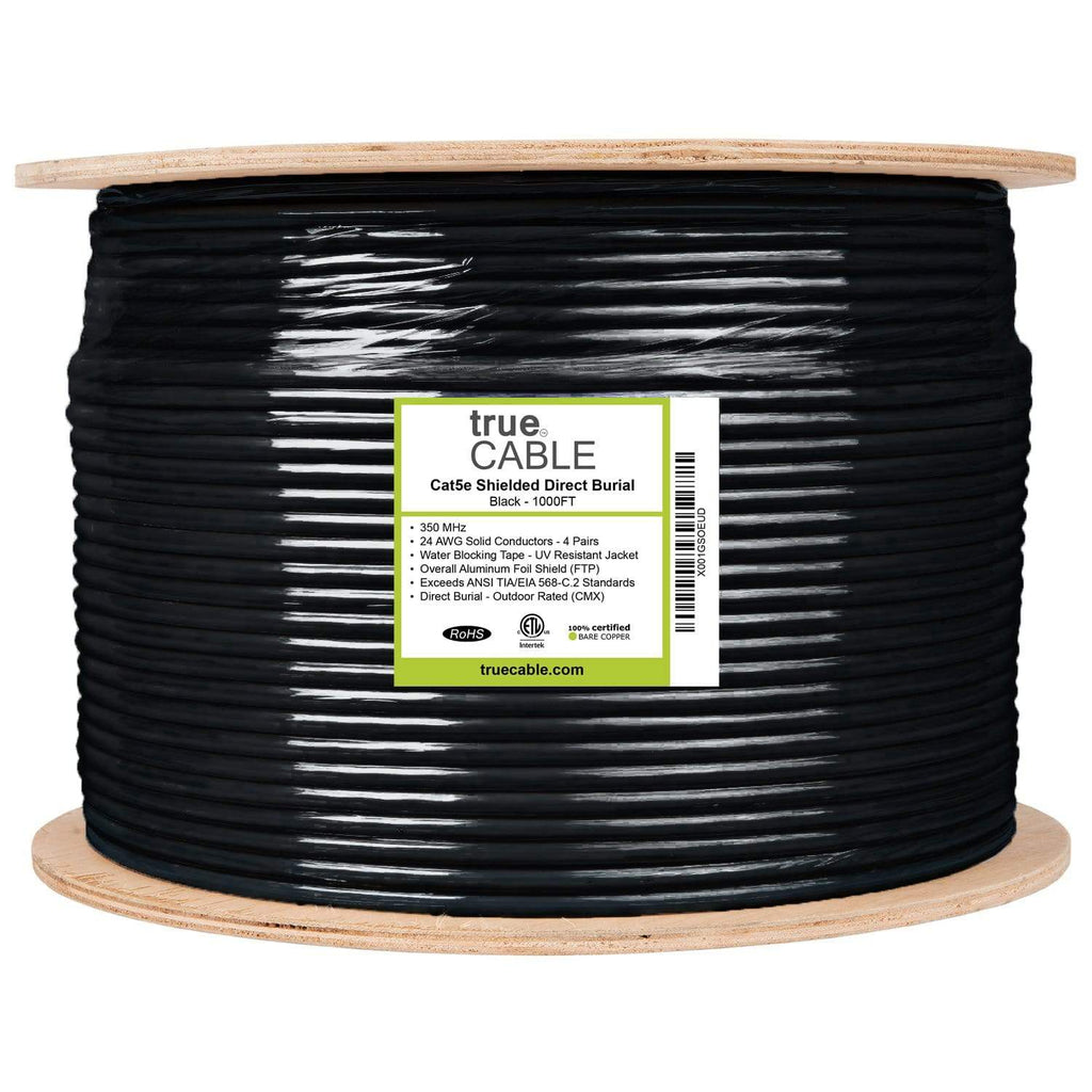

I'd still use direct burial-rated CAT cable for the heavier HDPE outer jacket it has that can better resist rocks, abrasions, cuts, etc. better than a CMR-rated PVC jacket.

I like truecables products.
