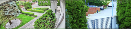

But having large sensor size is not the only way you can get better night time quality. Another method is having a large objective lens. It seems the only well priced cameras with large objective lenses are those hanging sphere cameras with huge optical zooms like 90x. They usually come with imx415 (so only 1/2.8 sensor) and cpus support 30fps at 4k, various so so ai features like human tracking, but the real reason why bought them are objective lenses up to 30mm and sometimes focusing infrared Illumination as well so you can use them for identify pretty well. The usual price is $200~$300, fast ptz, poe built in of course and two way audio. Usually hikvision firmware.
I've been testing two of them for quite a while and I'm about to buy 4 more. Tell me why I should buy something else please . I'm not posting any links because the usual sites are full of them.
