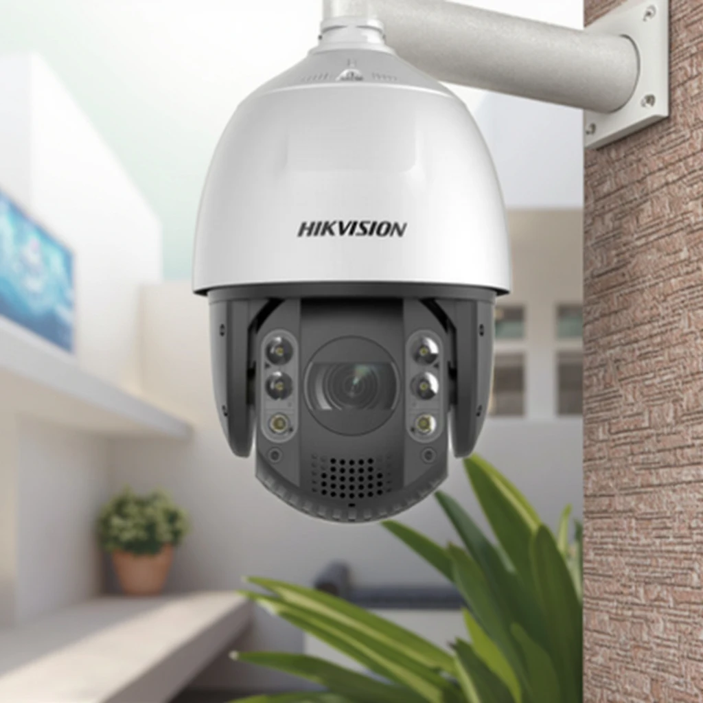

Darkfighter PTZ (DS-2DE7A825IW-AEB(T5)
Nov 11, 2024
25
4
For $600 this seems like a phenomenal deal. Has anyone used one of these as I have not been able to find many reviews.
Another question is this unit able to be powered solely off of POE or is the additional power supply going to be needed?
8MP with a 1/1.8" sensor thats made for 4MP?
No thanks

+1 this above.
The answer doesn't change from what was provided to you in your other thread. 8MP on anything other than a 1/1.2" sensor will result in horrible night performance. Especially for a PTZ. Buy once, cry once. Don't chase MP, chase sensor size.
