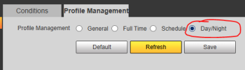

I am trying to configure separate settings (mainly shutter and gain) for Day & Night, however I am having some difficulty. This is the web UI:
You can see there are 3 profiles to choose. What I want to do is configure my settings for Day and Night profiles, and have the camera automatically switch between the two profiles, as the light levels change (as is possible on Andy's cams). However, the only options under 'Profile Management' are as follows:
- General: I assume this just uses the 'General' profile all the time.
- Full Time: This sounds like it uses either 'Day' or 'Night' profile all the time.
- Schedule: Allows me to set a time-schedule for each profile, but the problem here is that there is only 1 schedule for 12 months of the year - achieving a balance that will work during all seasons, I imagine, will be almost impossible.
Am I missing something obvious? Does anyone have any ideas? I had a similar issue on an older PTZ, and put it down to the age of the firmware. But this is a much newer camera, and it is ridiculous if this functionality is missing.

See my post #3 above yours - this option on older GUIs doesn't work the way we think/expect. All it does is takes one profile and then changes from color or b/w based on available light. It will not switch between day and night profile settings for shutter, brightness, etc.
I have set the Night shutter to 1/10,000, or something similarly ridiculous, and left the Profile Management mode on this setting:
I will wait to see what happens when it gets a bit darker and the cam switches to Night mode / b&w.
I think it might have actually worked. I modified the shutter, as mentioned, whilst it was still in color / day mode. I know it didn't immediately start using this shutter, as the image was still perfectly bright, even though it was getting a bit dim outside. Later, I checked again, and the image was totally black. I think it must have changed to night mode, and started using the very fast shutter. At this point, I changed the shutter to something more reasonable for night.
I assume since then it has been changing back to day and then to night again. I did have to go slower on the night shutter than I would like, to get an image that was bright enough to be useful - I reckon the sensor size is probably way to small on this camera.
