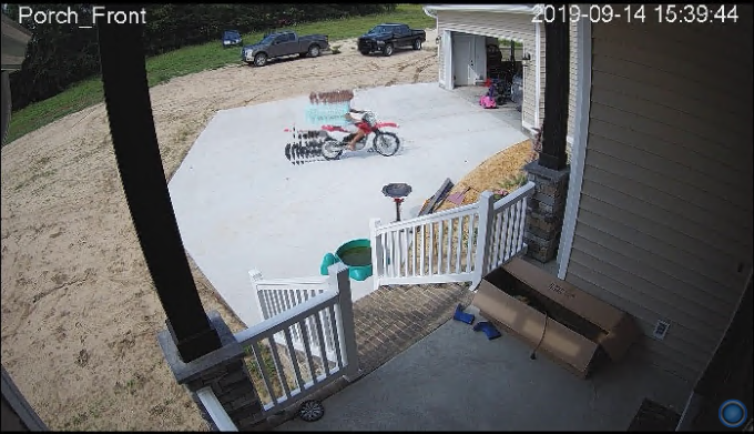

I went from 265 to 264H and turned smart codec off. I'm basically using 10x more storage than I was using with 265 and smart codec ON. Is 264H 10x better?
I tried swapping back to H265 with smart codec ON so I could compare some video but now I'm having an issue with the cameras indicating "No Signal" in BI. I even deleted all my cameras and re-added them. I'm still getting "no signal" on 1 or 2 cameras at any given time.
