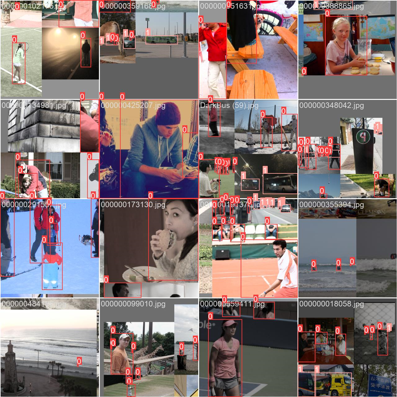

Here is the original with only 3 val and test pictures:
I reran the training with yolov5s.pt and 25 val and test images each:
Lastly, while I was doing that I found something on the roboflow site recommending a 70/20/10 split so here's that one too lol:
Annoying, there doesn't seem to be anyway to shuffle the dataset on roboflow? So for like the 25 val/test version, they were almost exclusively bear pictures instead of a random representation. The 70-20-10 split is a little better.

I normally train with a 90-10 split, you do not need the validation images. you can also try training with 100 epochs. All my models are trained with 75 to 200 epochs using as much as 100,000 images and can take over 24 hours to train using a RTX 3090 GPU.
Also below is another graph to tell how well you model trained, the closer to 1.0 the better the models is.
MikeLud1
Apr 5, 2017
1,886
3,736
Brooklyn, NY
When training you what to see the graph that are highlighted in blue going down (lower numbers) and the graphs highlighted in green going up. If the model is not improve then the best.pt does not get updated.

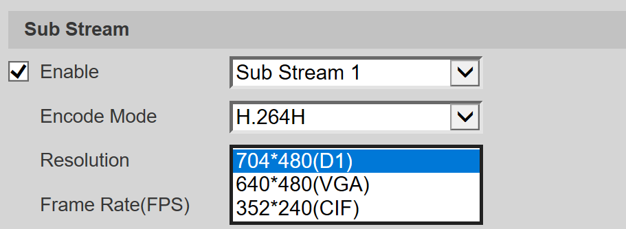

Use ether D1 or VGA for your Sub Stream. When training it does not stretch 480px it fills the rest of the image with the color gray
Didn't want to clog up the BI DAT tool thread, but I've racked my brain with this very problem so I'll ask/continue it here lol.
I've spent a lot of time wondering what aspect ratio/sized images are best to train my model on....Here is an original image and 3 examples preprocessing trying to get the most accurate image to train on.
Starting with this ORIGINAL image:
1. Pre-crop the "long" edge, square without changing the height - (keeps a 1:1 image ratio. After shrinking to 640x640, keeps accurate/proportionate sized objects the camera/AI will check)
2. Fill-in pixels to the short edge - (keeps the image square, but once the image gets shrunk to 640x640, the resulting objects are smaller than in reality (and smaller than the camera/AI will see/check in practice.))
3. No manual pre-processing at all. Roboflow will/could squish the image square - (Super unrealistic skinny objects to train on.)
As much work as manually cropping images square is (compared to letting Roboflow "fill-in" or "squish" automatically during pre-processing), so far I've figured it'll give my model the best data to train on.
In regards to using 704x480 (D1) substream images, I still think there would be some benefit to cropping it square 480x480, then enlarging the image to 640x640 in both dimensions. That way, proportionally, the objects would still take up a realisictic amount of pixels/screen space.
Thoughts?

When training it would best to use images preprocessed with both option 1 and 2 (undistorted) because when using the model the image will be formatted like preprocess 2 (undistorted) .
If you resize the images 480x480 the model will decrease in accuracy
