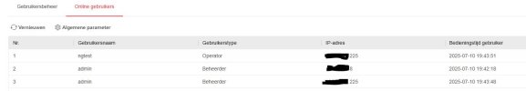

This is the online users list when accessing the camera directly, it is showing the "ngtest" user as "online".
