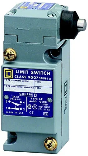

Usually NO- means a normally open contact and NC - means a normally closed contact.
In an alarm state these input contacts will trigger the required output. They can be both hardware i.e door switch or software ( written into the program ). The drop down menu is an example of adjusting the software program too get the required output / results.
If i remember right this started in the 80's. Large scale manufacturers i.e the motor industry were able to quickly adapt / change production lines using software rather than the labour intensive and time consuming methods of running new cables, switches and rewiring control panels. Do a Google on programmable logic controllers PLC if interested.
See link for contact explanation below and Good luck
PLC's came about as you could have a multiple cabinets of relays (very large cabinets) and reduce that footprint to 2 or 3 square foot instead of 100's of square feet of backplate mounted, clunking relays. Troubleshooting a relay controlled machine line was pure nightmare, as there were so many connectivity points that you could lose the signal at. You had to take your meter and a roll of prints, start at one end of the circuit and keep tracing until you found out where you had either a loose wire, a pitted set of contacts or a relay coil that gave up the ghost. In PLC's you had input and output cards that the devices were wired directly to and you could use the ladder logic program inside of the PLC to quickly pinpoint which device was not working.
The new PLC's are now all ethernet capable, so a engineer can troubleshoot a machine anywhere in the world on his laptop from his easy-chair while sipping a beer at home. They make all types of cards that can go into the PLC's, which allow you to control and monitor virtually anything you want. And they are cheap, too. (Except Allen Bradley. They are way, way too proud of their shit)
