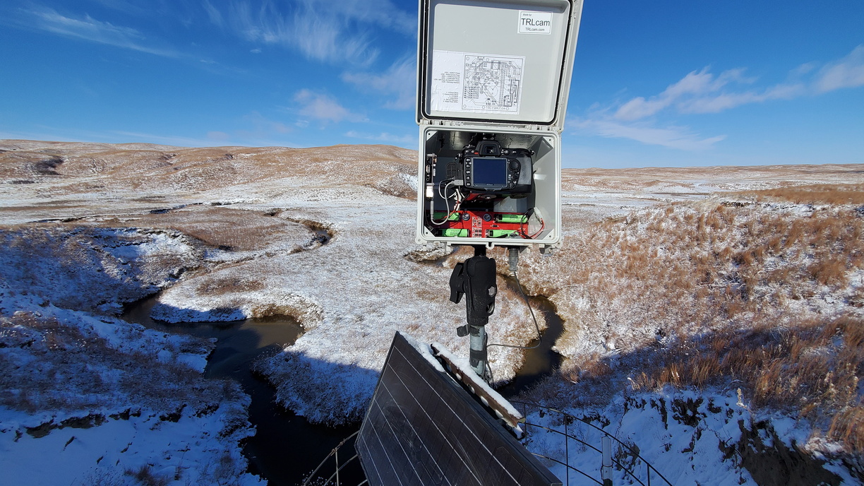

Here is one of the timelapse cameras. The camera is a Nikon D300. The controller is on the left and is a Raspberry Pi with a custom board plugged into the 40 pin GPIO connector. On the board is a GPS module, real time clock, a TI MSP430 that controls the sequence of events, several status LEDs, a switching power supply for 8vdc camera power and another for 5vdc Pi power. Power is provided by one 30 watt solar panel and stored in four Panasonic 18650 lithium ion batteries mounted on a custom PC board.
