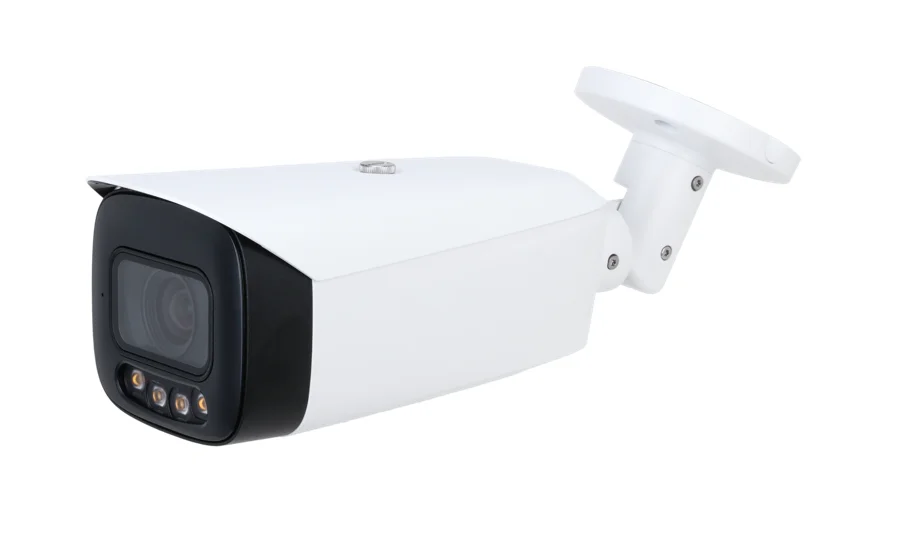

Installed my camera system couple years ago, getting everyone from Andy (Thanks Andy) been trying to keep up with the forum and all thew new things coming out, which there is way to easily find when new replacement is out. Either way, would love some help to figure out if there is anything better out. I would love to use the boxes that are already mounted out. Here is the list of cameras that I currently have:
IPC-HFW5442E-SE
IPC-B5442E-ZE
IPC-T5442TM-AS
Thanks!

The color 4k/x is the current champ but it is only fixed lens. No varifocal replacement for the 5442 yet.
