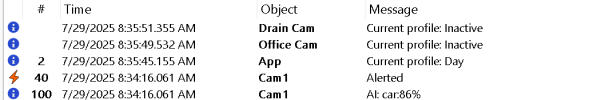

still playing around with it. I did find that I can just configure one camera to a "Action set1" but then just keep adding more cams, I also put a 1 sec. wait time between switching, not sure if it needed that, but it works great.409.jpg
I found that you do NOT need any delay between the web request. I had one of my cams wrong and that is why it wasn't switching. Now it all works great
Action Set 1 I used for sunrise
Action set 2 I used for sunset
Then just added all the cams I want to change under ONE cam's schedule....no more messing around with PTZ presets.

yes, I use the same string on my IPC-Color4K-T180 and it works fine. Also use it on older Dahua cams.
night profile string: user:password@192.168.200.149/cgi-bin/configManager.cgi?action=setConfig&VideoInMode[0].Config[0]=1
day profile string: user:password@192.168.200.149/cgi-bin/configManager.cgi?action=setConfig&VideoInMode[0].Config[0]=0
SO I suppose the day profile string would almost identical except for the last Config[0]=0 ??? or do you have to change the value in VideoInMode[?} as well?
Just the zero, I'll paste it above as I should of before but it was late :)
