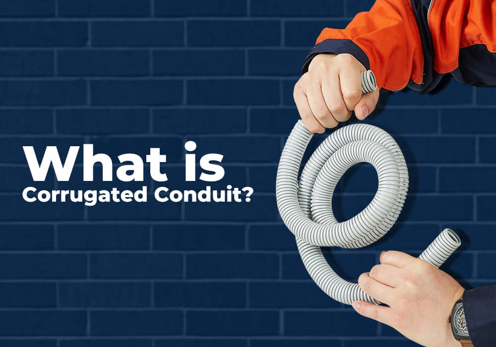

I know this was addressed to someone else, but I can share my experience. Living the islands, virtually all construction is masonry which leaves no gap, attics, etc to run cables. So, the outside runs are either done in PVC conduit or corrugated conduit. The corrugated conduit is cheaper to install not only because the material is cheaper but it can also be bent which makes instillation faster since elbows are rarely used.
PVC holds up better in the sun so it's worth the extra expense to have it done once.
We run normal CAT6 inside the conduit and have virtually no issues.
