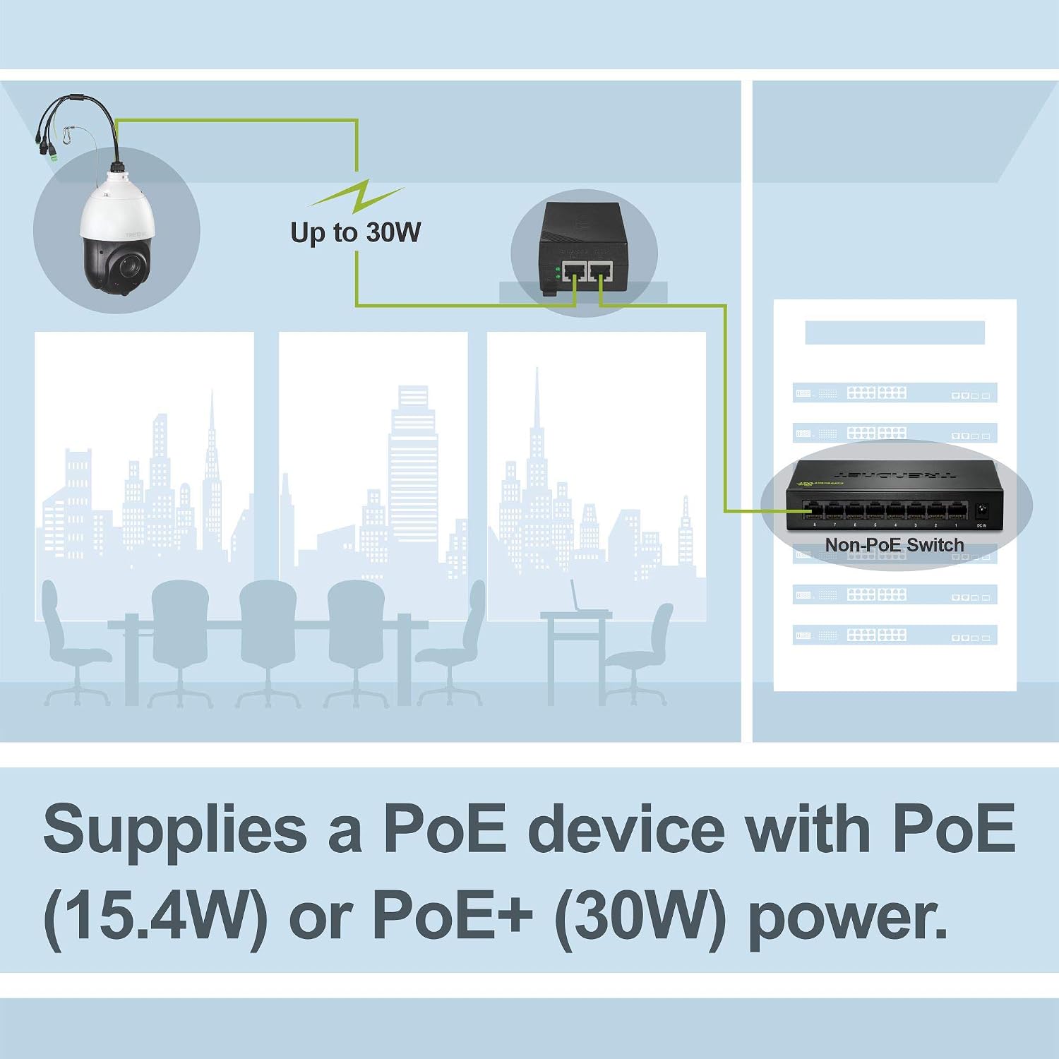

ED - I have the setup you are looking to purchase. I found both the TP-Link switch (8 port) and the 24-port V7 Switches I have, not able to handle the power requirements even though they are both rated as POE+ switches. The PTZ1A225U-IRA-N would just continually reboot forever until it was unplugged. Ultimately, I went with an external POE+ power injector, made by Trend Net, and that works great. Just a thought on what that camera seems to require.
Does this take the place of a POE switch or does it go between the camera and the switch.
It goes between camera and non-POE.

Nice, thanks looney. Total of 123w which is double most of the others switches. Just off the top of your head, would 15w per port be fine for the 2mp Starlight cameras if all 8 ports were used?
That should be more than enough. In reality you'll probably be using around 5w per camera, if not less.
