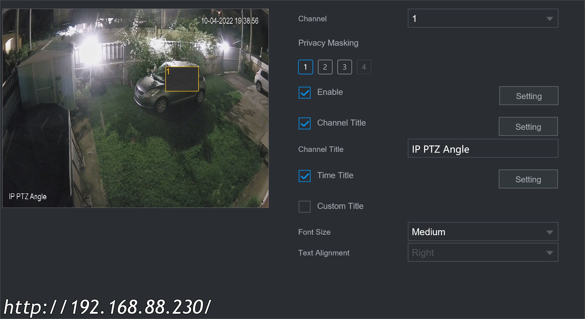

Hi Cor
i have same model SD2244T-GN but cannot configure privacy masking.
once configured, when i save, the mask disappear, even web or console (system version is V4.001.0000003.2, Build Date: 10-10-2020 )
can you tell me how you can do that?
thanks

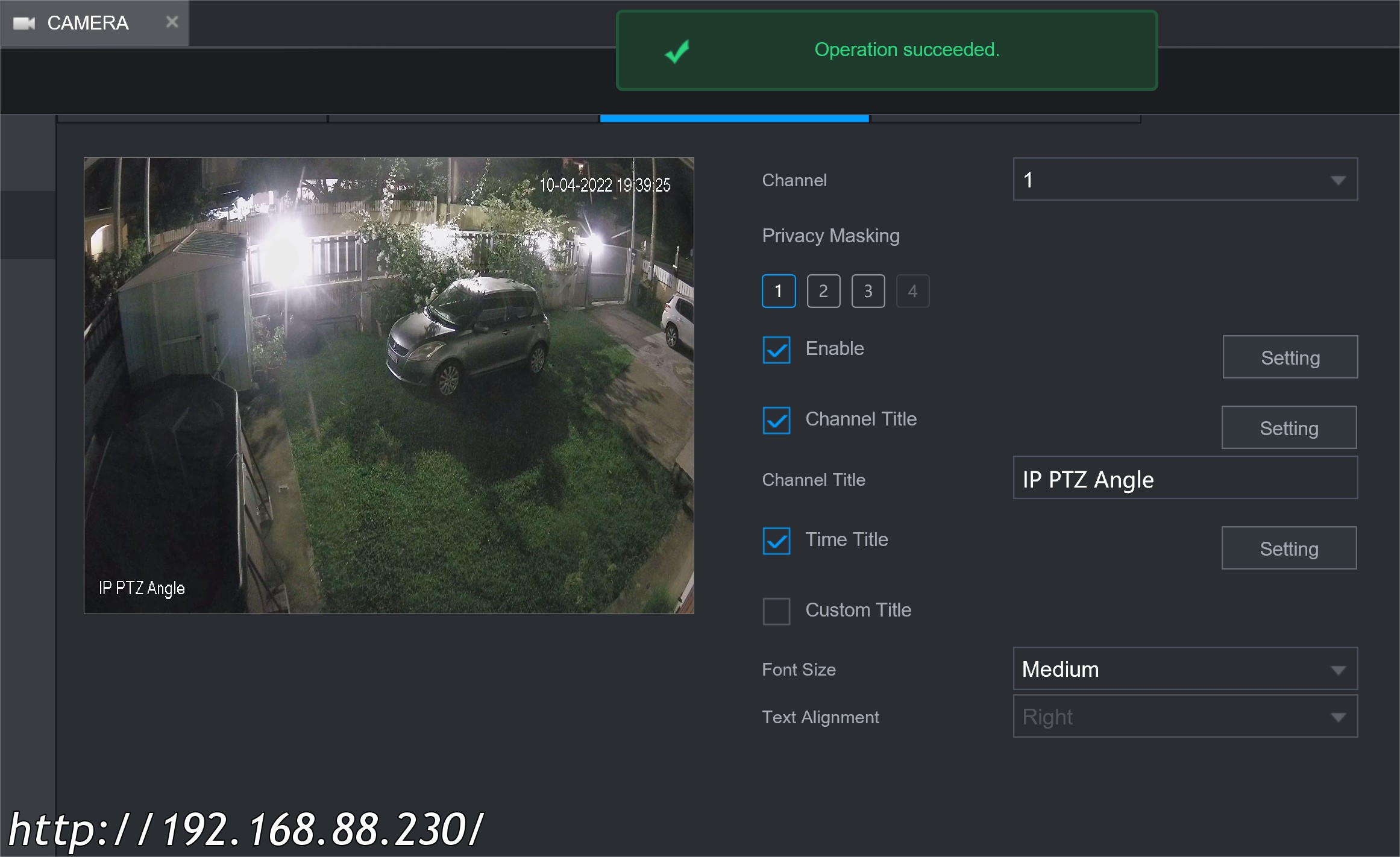

Hi
I use chrome.
bu just try with IE11, and have same problem:
as shown on picture, when configured, you can see the mask square, but once applied, the mask disappear.
PS: for Fixed cam, the mask is working. I have this problem only with SD2244T-GN PTZ while 24 privacy masking are available by spec of this model...
any idea welcome.

Hi
I've resolved the problem, some restrictions for dahua PTZ cam:
  • use IE 11 only
  • download NACL as expected.
  • connect directly to IP CAM to configure privacy masking,
  • DON'T configure privacy masking through NVR, change will not saved
