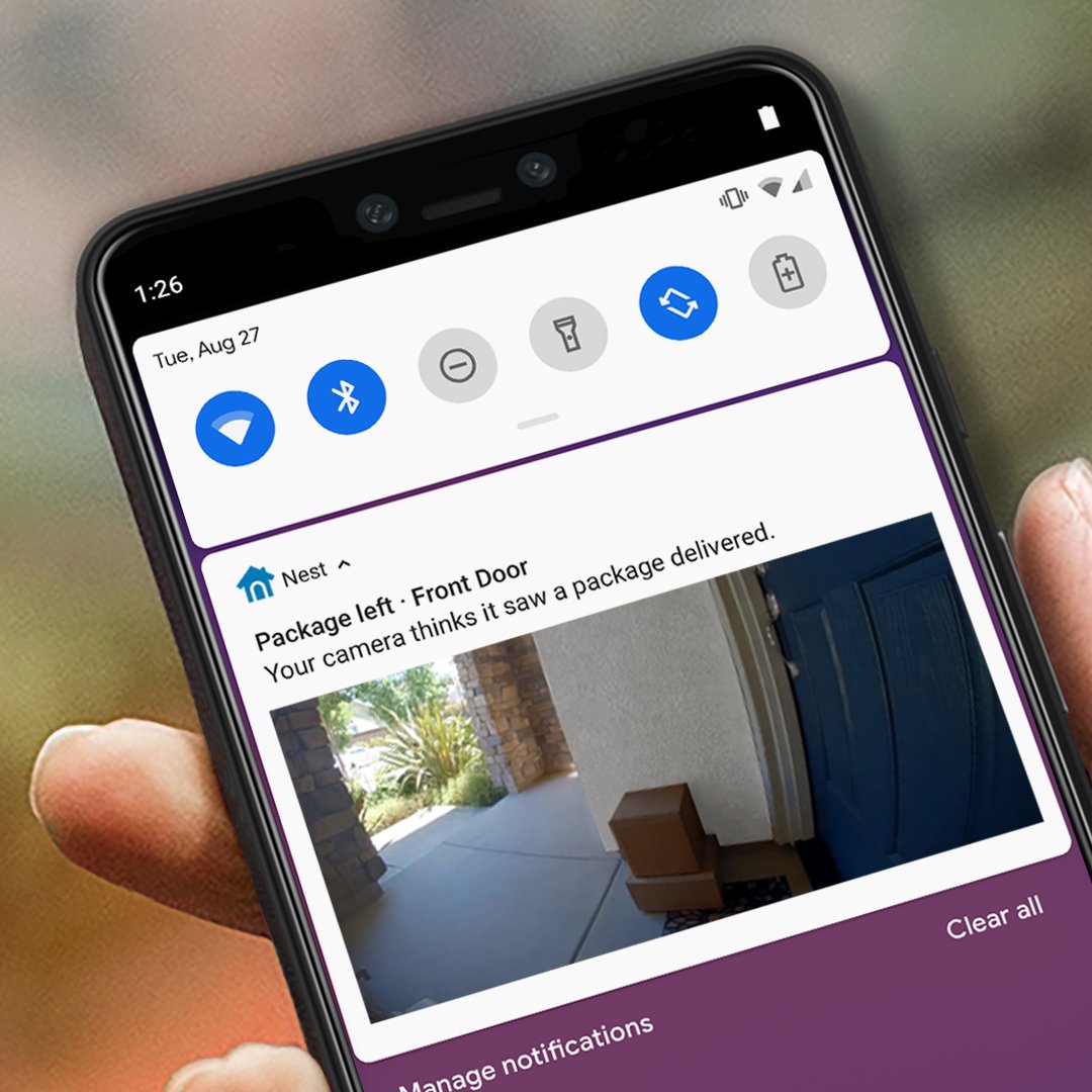

I've searched around online and can't find anything about it.
I don't think it's possible to get push notifications (with gDMSS/DMSS) with a camera snapshot attached right?
Something like this.

Hmm, I'll have to look at the settings on the app/camera, because when I click on the notification; it directs me to the recording; not a thumbnail/snapshot.
Preferably I would like to have a push notification like the one I posted in my first post, but I guess that's just not possible with Dahua.
Also; DMSS push notifications are pretty much instant here. But maybe that varies per situation.
That's true, push notifications are instant, however if you click on them, it takes sometimes a while before the thumbnail opens. If I remember correctlty, you can indeed setup to: "play recording / show thumbnail / play snapshots" option when clicking on the push notification. But I can be mistaken :cool:
Hmm, maybe I'm not looking correctly; but in the new DMSS I can't find a way to show the snapshot.
In the old app (gDMSS Plus) I can indeed select "Live Mode", "Video" or "snaphot".
Is this still the case with the current DMSS IOS app. I am in the same boat as the OP wanting to somehow send a snapshot with the alert but can’t see any option in the app. :(
