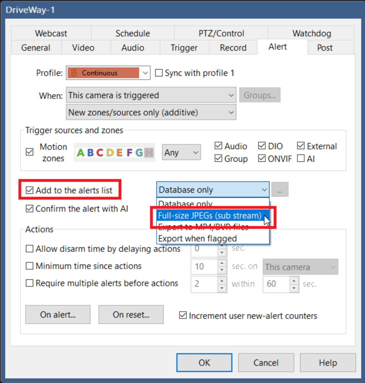

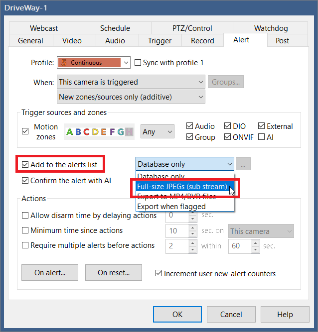

Hmm, it looks like selecting
just results in Blue Iris saving a JPEG off of the Low Resolution Stream :-(

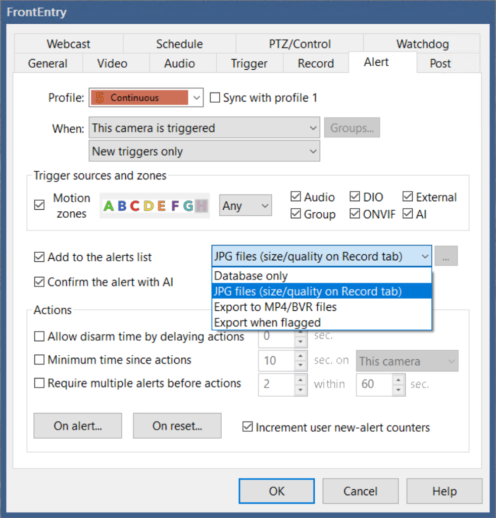

The only high resolution .jpg is still the one from the Record tab
So, still looking for a method to include the high resolution .jpg in the Pushover notification.
I found a solution; cloned the cameras and selected only the Main stream on the Video tab > Configure. If someone has a more elegant solution, please let me know.
