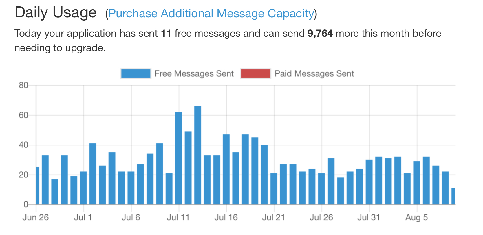

Have you checked your Pushover dashboard to see if the server is receiving API commands? Here’s an example for one of my Application tokens…

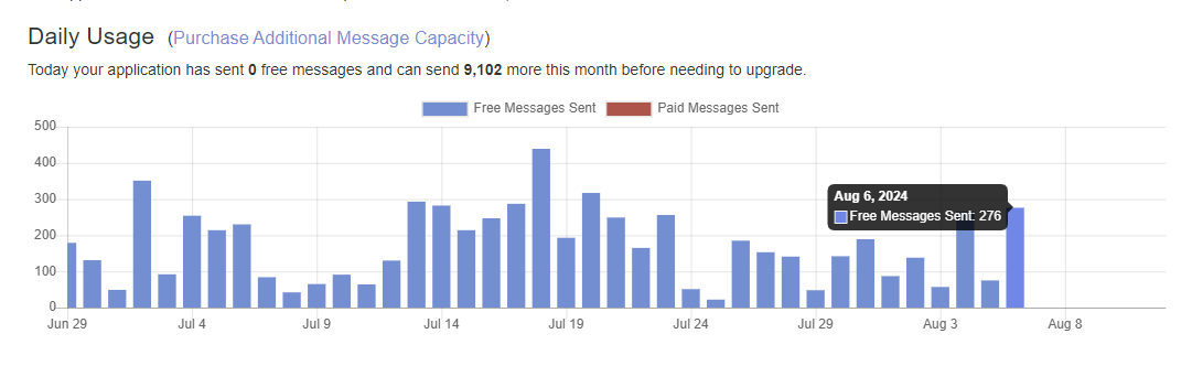

Seems Blue Iris just stopped sending messages since the 6.
Or your Pushover account stopped receiving API requests.

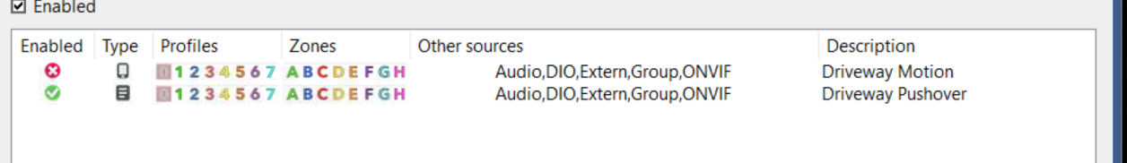

Make sure the alert's pushover Action is not disabled, or otherwise prevented from executing by the profile/zones/inputs settings.
Are you refering to this? the enabled alert is push, all of my camera have it enabled. When I test the alert it says complete but nada
Yes. This looks good.

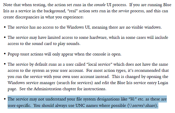

The only thing that happened was my storage drive died but I've since moved the path to the new drive and also changed the drive letter to match.
EDIT: I sent this reply before seeing your response above
If you mapped a network drive to a letter, and are running Blue Iris as a service, then you might be running into the following issue described in the Help PDF... see the final bullet.
From the Help PDF, chapter 'Alerts and Actions', section 'Testing the Action Set'.
