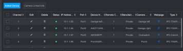

Yeah, totally makes sense. I know you guys always preach about one camera not being the end all. I do have 3 other T54-IR in addition to that 180 in the front of my house to capture approach to the front porch and two under the garage. That 180 is a nice overview camera as you say, I’m just looking for additional camera that will pick up identify detail say out at the sidewalk when any of my spotter cams would pick up somebody walking there or even across the street. You can get a feel for where my spotter cams are currently placed below.

That Camera labeled LPR is probably better for ID of faces, pretty close to where its at already. Maybe a tooch more zoom.
With that angle I can't imagine you are getting high percentage reads at night anyway

Yea man the angle kills me but my home is on a big sweeping curve and I dont have ANY good angle so I do the best I can . That Z4 is zoomed all the way in. I get great captures in the day and like you mention, at night it is much more difficult. Below you can see the older style reflective plates are much easier to read than the newer 3M. I thought about replacing this cam with a Z12 for the extra zoom to get closer to the plate. Nothing I can really do about the angle however.
