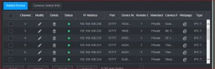

Its 1 IP address. 3 channels
I'll test that later tonight or tomorrow, Currently mine's on as witch just becasue thats where the wire I had open goes to with a splitter no less
I'd be curious to know how that works and if you can connect to one port on an NVR and configure for 3 channels And of course how its done
Notice below that 2 NVR channels have the same IP address, but different remote channel settings (this is for a 2-channel thermal camera).
Yeah that’s how mine looks right now on a switch only 3 with the same IP
I’ll try it on the NVR poe port later
