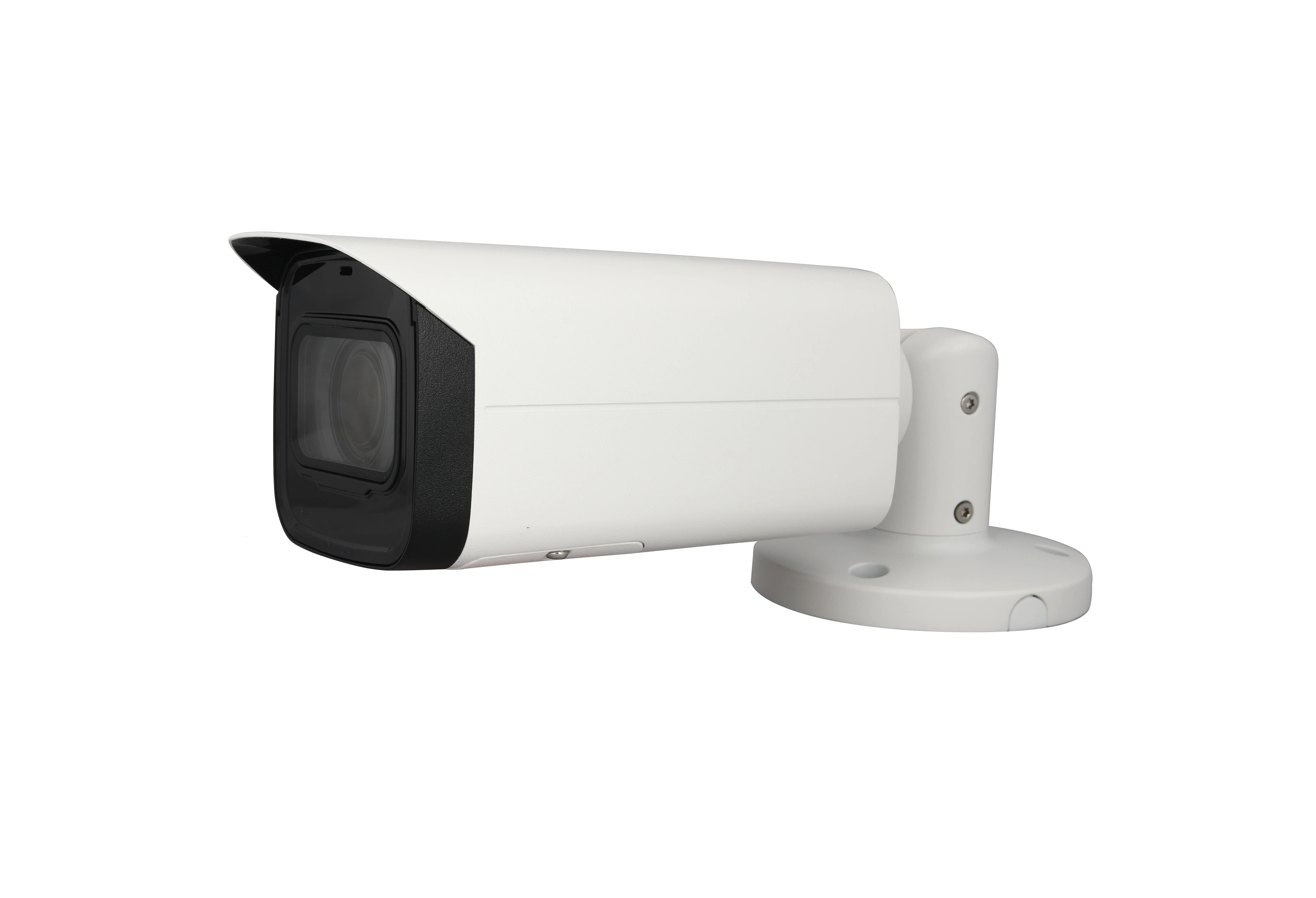

The IPC-HFW2831T-ZAS-S2 has a built-in mic but is not a turret model
Interestingly the HFW2831T-ZAS (version 1.0) has the 1/1.8 sensor whereas the S2 version has 1/2.7 sensor, sporting same model number :confused:
Note: Original ZAS bullet model with built-in mic has the 1/1.8 sensor and was 8mp (supporting 30fps 4K!), but is no longer available
Here is the S2 model (only 15fps 4K)
Here is the original ZS model (w/o mic but still has 1/1.8 sensor F1.9, which should render better image quality) and supporting 30fps at 4K
Would have been nice to see DH-IPC-HFW2831T-ZAS available as a turret model
I feel like the model @looney2ns reviewed here could still be a good contender seeing that it has a F1.5 aperture versus the IPC-HDW5831R-ZE (F1.9 aperture) :) HFW1831E has a F1.6 aperture but with 1/1.8 sensor. I'm not sure why this turret(being a newer model) only supports 15fps at 4K, still puzzles me. Would be great to see more detailed side-by-side comparisons :D Guess we can't have everything in the lite series category :p :idk:
