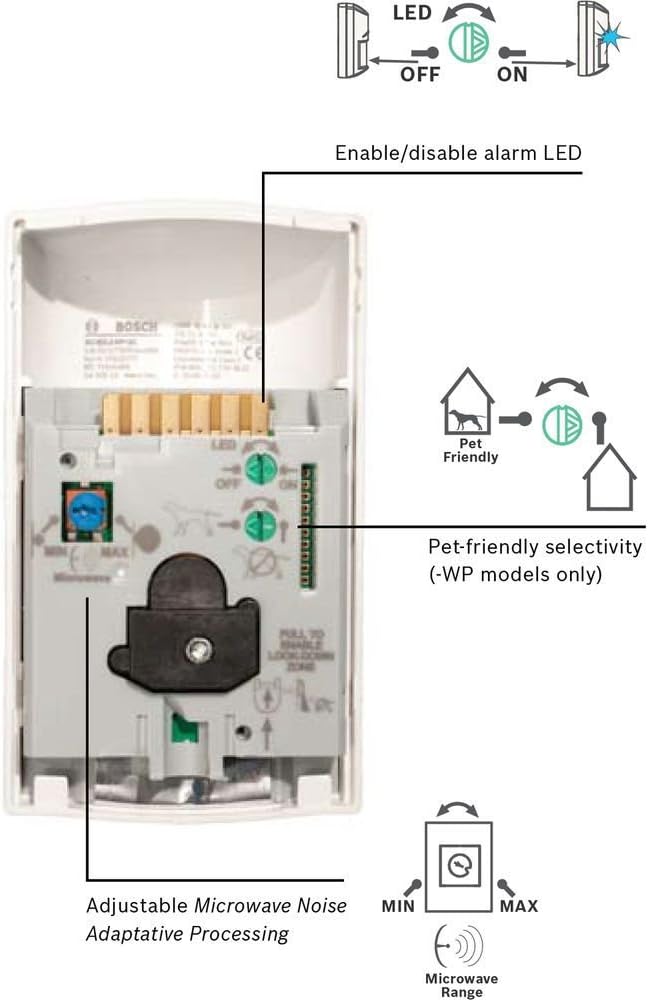

I'm looking at the Bosch Tri tech detector @Rebelx mentioned. From what I can see, it has both microwave sensor and PIR.
The good part is that the PIR sensitivity can be adjusted. But the microwave detector is definitely going to pick it up, I'd assume the sensors processor would use both PIR and microwave to prevent pets triggering it.
I'm still mixed weather this would trigger an alarm, all I can recommend is testing.
Image URL (from Amazon): https://images-na.ssl-images-amazon.com/images/I/61IjMR42FpL._AC_SL1000_.jpg
Although this costs an arm and a leg, there exists motion detectors that have a special collar for you pet (attach to the vacuum). I heard this from someone who has tall dogs but I don't know the keywords to search online.
