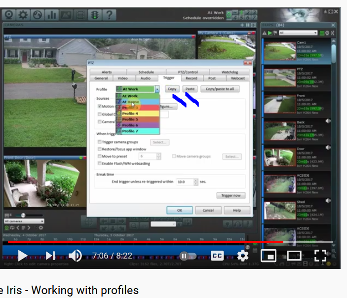

Thanks @looney2ns
I'm stuck halfway through after watching videos.
I've had my night/day schedule running for my exterior cams well for a year.
Now created a new profile 'Away' so it switches the trigger motion on for the indoor cameras also.
BUT this applied to all cameras and now for the 4 exterior cams I want to copy the night and day settings to the new 'Away' profile.
I can't see a method without having to manually update all the exterior cameras matching the original profile Day/Night.

This copy/paste function has gone in v5.
What is the equivalent?
