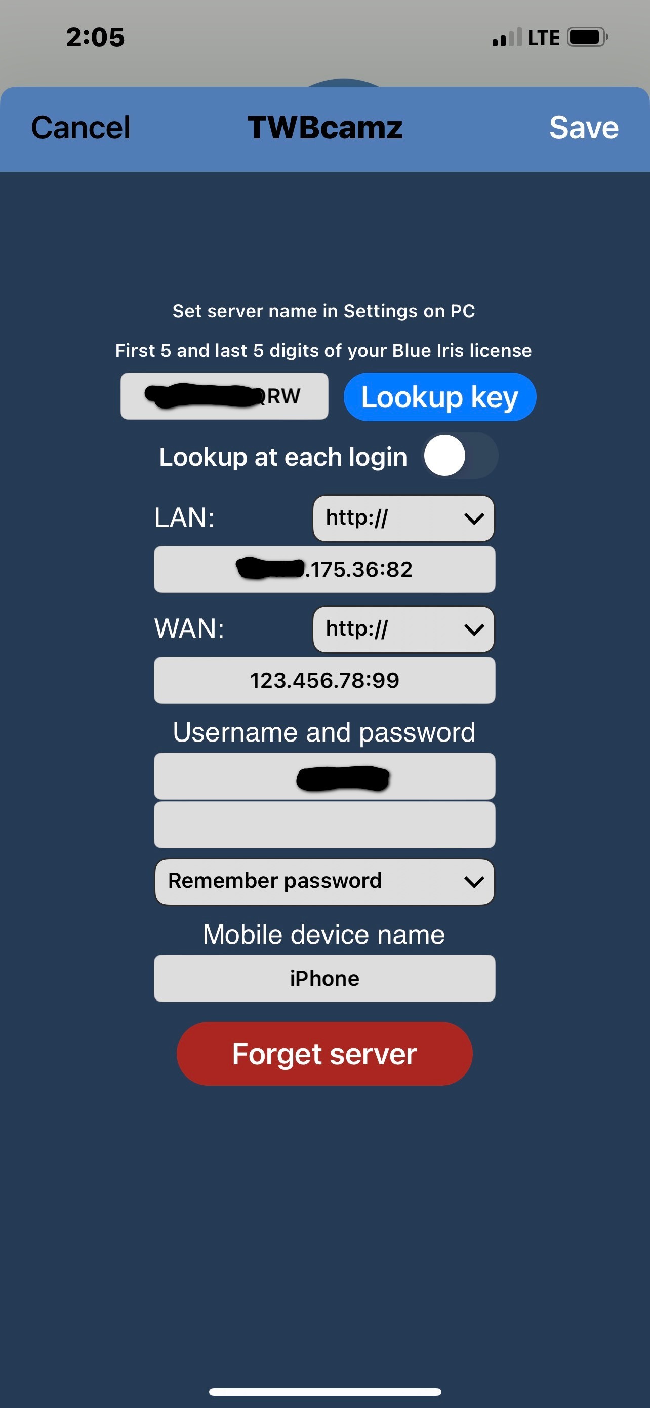

On my phone I have the Blueiris Tailscale IP entered in the "LAN" setting on the app and found in the WAN line that anything will work. Here are my settings and you can see that my WAN is 123.456.78:99

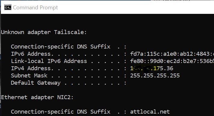

Does the ipv4 address show for Tailscale if you do ipconfig command from the command prompt?
Out of curiosity, on my phone browser I entered the BI Tailscale address followed by my ;8x port and it opened BI's UI3 screen.
