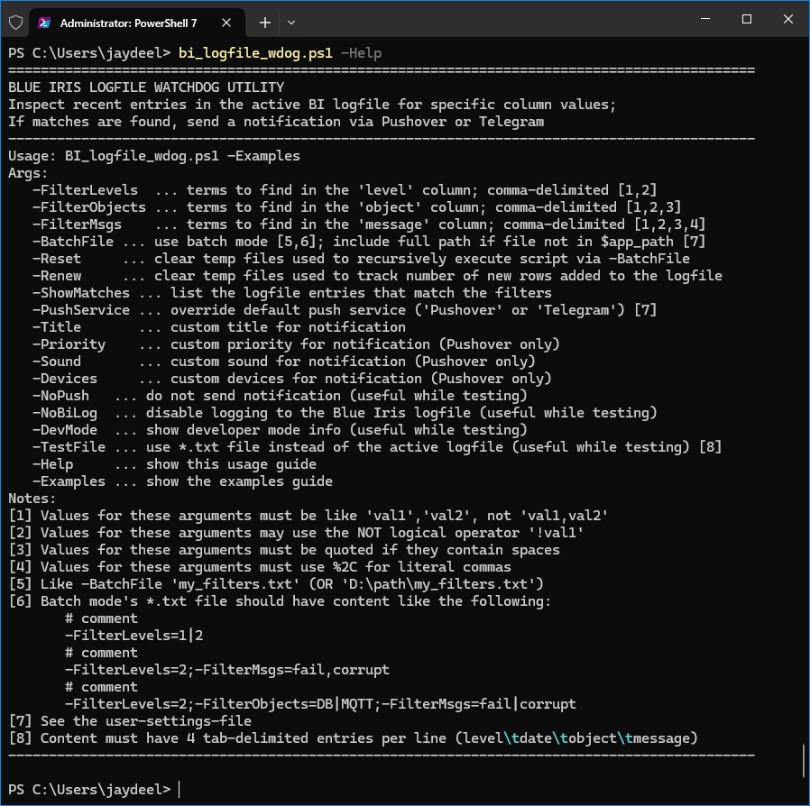

  • It has a convenient help guide BI_logfile_wdog.ps1 -Help

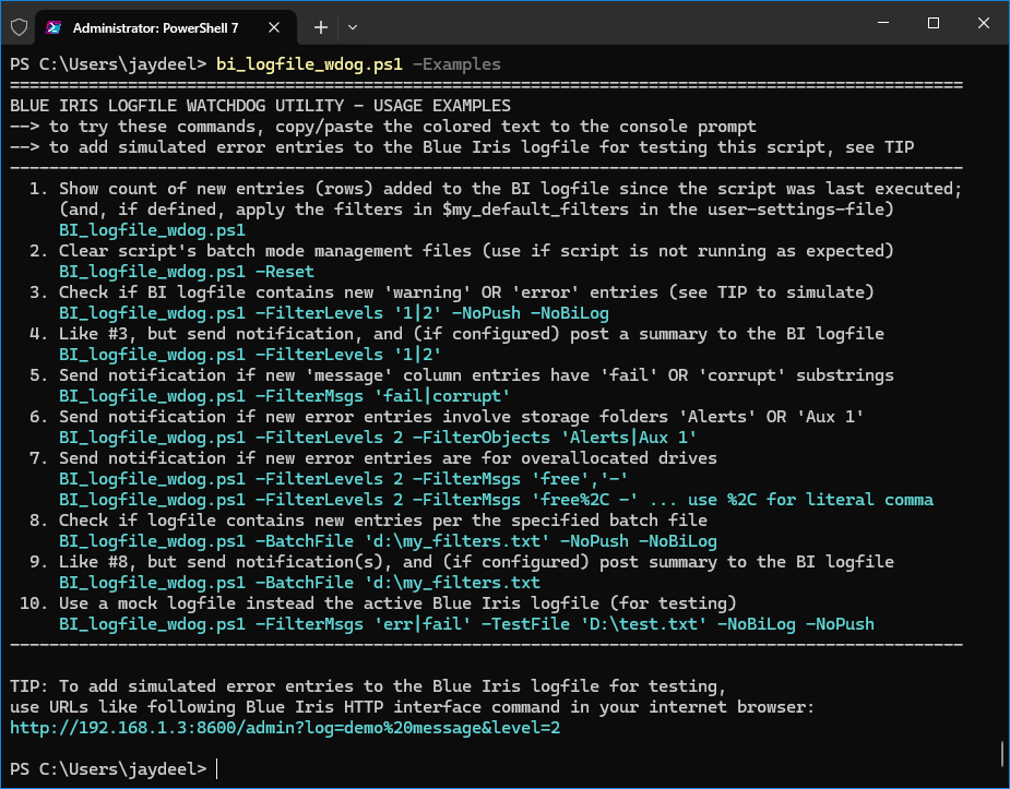

  • It has a convenient examples guide BI_logfile_wdog.ps1 -Examples

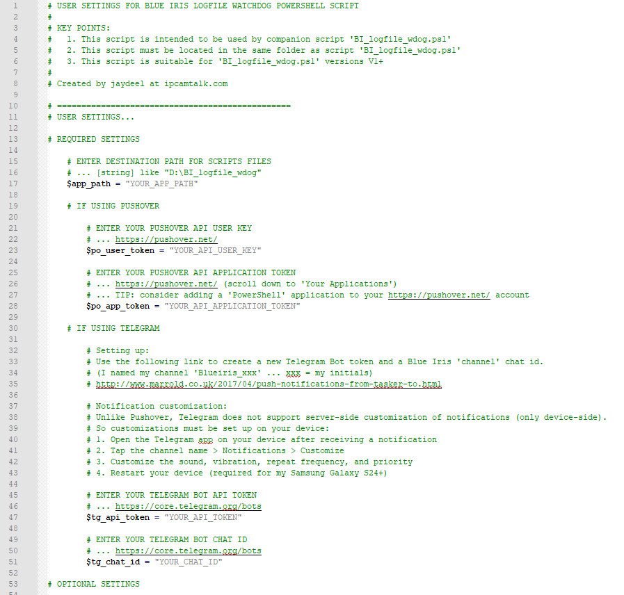

Edit the user settings file
The user settings file is named 'BI_logfile_wdog_user_settings.ps1'
  1. Open the file in a text editor (a code text editor is recommended; I use Notepad++)
  2. Edit the REQUIRED SETTINGS section (see screenshot)
  3. Ignore the remaining settings for now. They provide customizations that you may want to explore later.

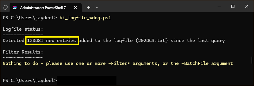

Test the script from the PowerShell console
Open an Admin PowerShell window, or Powershell-ISE window​
3.1 - Select and copy the following command and paste it into the console.
BI_logfile_wdog.ps1
Hit the Enter key.

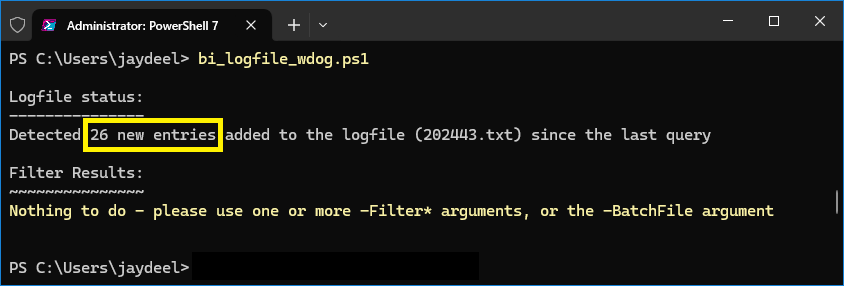

  1. The first execution will show a count of all entries the active logfile.
  2. Wait a few seconds (maybe longer), then repeat the command.
  3. Now it will show the number of new entries in the logfile.
The response should look like following 2 screenshots:
3.2 - Select and copy the following command and paste it into the console.
Hit the Enter key.
  1. Look at the bottom 'TIP' section.
  2. Select and copy the URL.
    The URL should be like, http://<ip_adress and port>/admin?log=demo%20message&level=2
  3. Paste the URL to the address bar in your Internet Browser
  4. Hit the Enter key.
This will add a new error entry to your Blue Iris logfile that we can test in the next step (3.3).
Note that you can edit the URL as desired to create ANY demo issue you want to test.

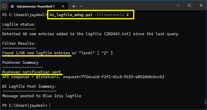

3.3 - Select and copy the following command and paste it into the console.
BI_alert_protect.ps1 -FilterLevels 2
Hit the Enter key.

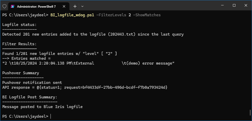

The response should look like following screenshot:

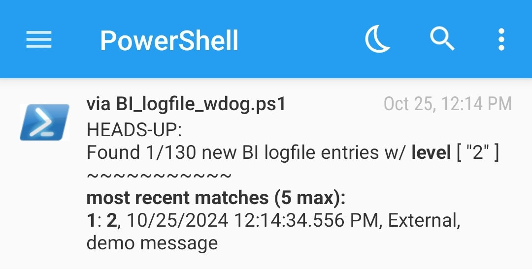

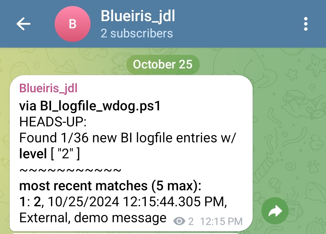

And the command should send a notification to your Pushover or Telegram device that looks like one of these 2 screenshots:

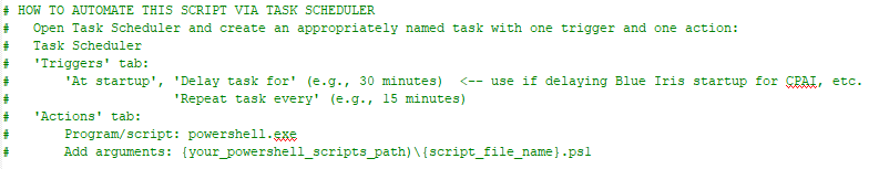

Automate the script from Task Scheduler.
USAGE GUIDE Screenshots:

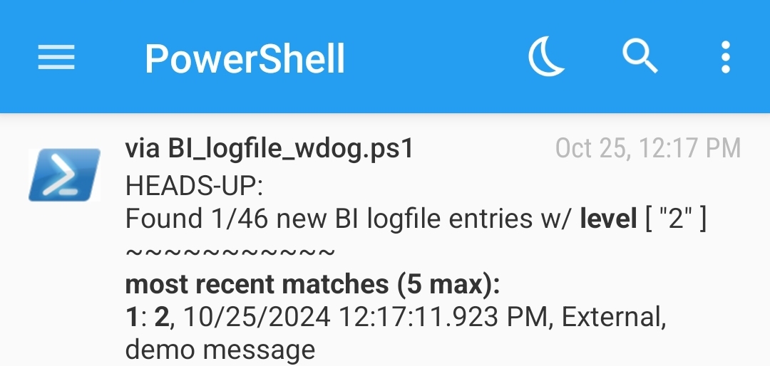

2. Send a default notification if the Blue Iris logfile has recently added any error:
BI_logfile_wdog.ps1 -FilterLevels 2 -ShowMatches
Note: Argument -ShowMatches applies only when the command is executed in the console. The argument is ignored when the script is executed from the background, e.g. via Task Scheduler, or a Blue Iris Action.

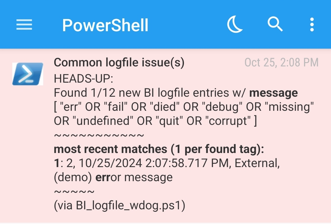

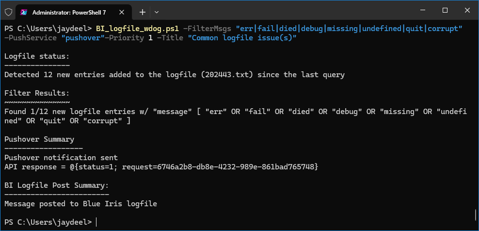

4. Send a priority 1 Pushover notification if the Blue Iris logfile has recently added any of the specified common issues keywords:
BI_logfile_wdog.ps1 -FilterMsgs "err|fail|died|debug|missing|undefined|quit|corrupt" -PushService "pushover"-Priority 1 -Title "Common logfile issue(s)"
Note: Argument -FilterMsgs is using OR logical operators (pipe character '|')

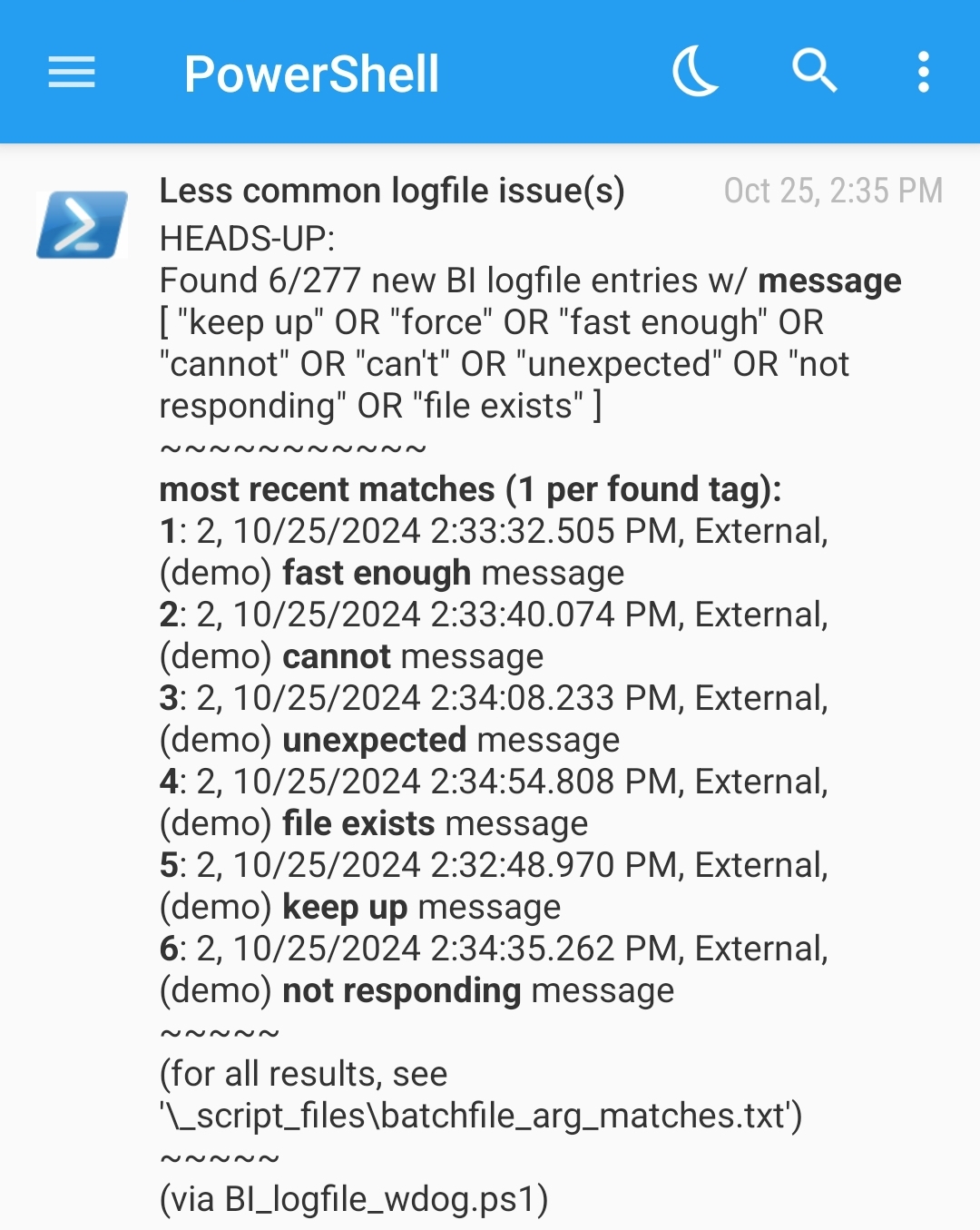

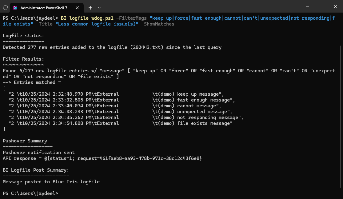

5. Send a default notification if the Blue Iris logfile has recently added any of the specified less common issues keywords:
BI_logfile_wdog.ps1 -FilterMsgs "keep up|force|fast enough|cannot|can't|unexpected|not responding|file exists" -Title "Less common logfile issue(s)" -ShowMatches
Note: Argument -ShowMatches shows ALL matches, while the Push notification only shows only 1 logfile entry per match when the filter argument has only OR logical operators. This is done to avoid an excessively long notification message.

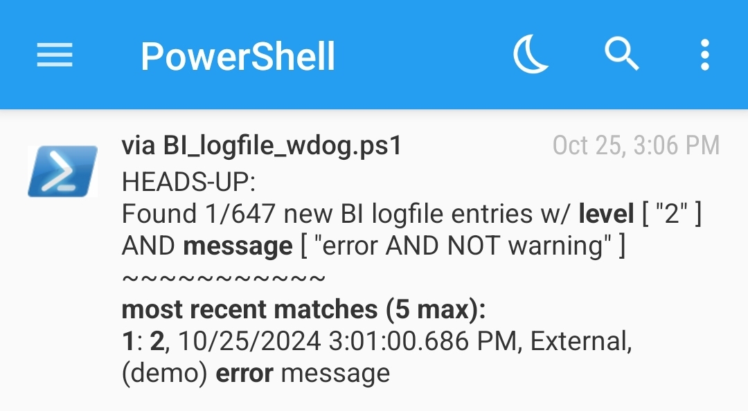

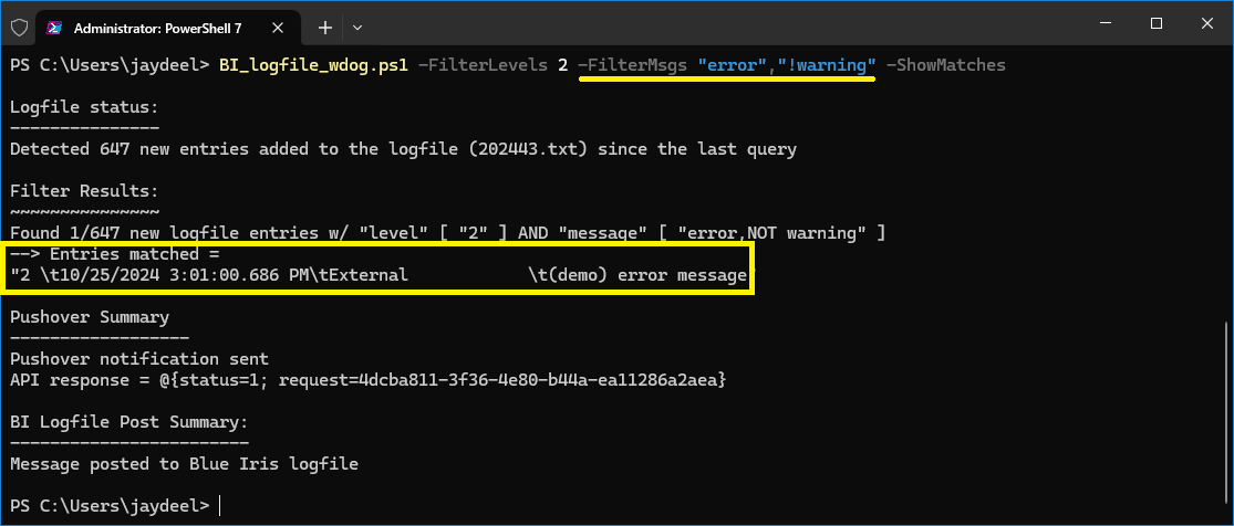

6. Send a default notification if the Blue Iris logfile has recently added error entries with warning or error keywords:
BI_logfile_wdog.ps1 -FilterLevels 2 -FilterMsgs "error","!warning" -ShowMatches
Note: Argument -FilterMsgs is using both AND and NOT logical operators
The tested logfile contained these entries...​
2 10/25/2024 3:01:06.556 PM External (demo) warning message
2 10/25/2024 3:01:00.686 PM External (demo) error message
But the script command matched only the 2nd (as expected).​
