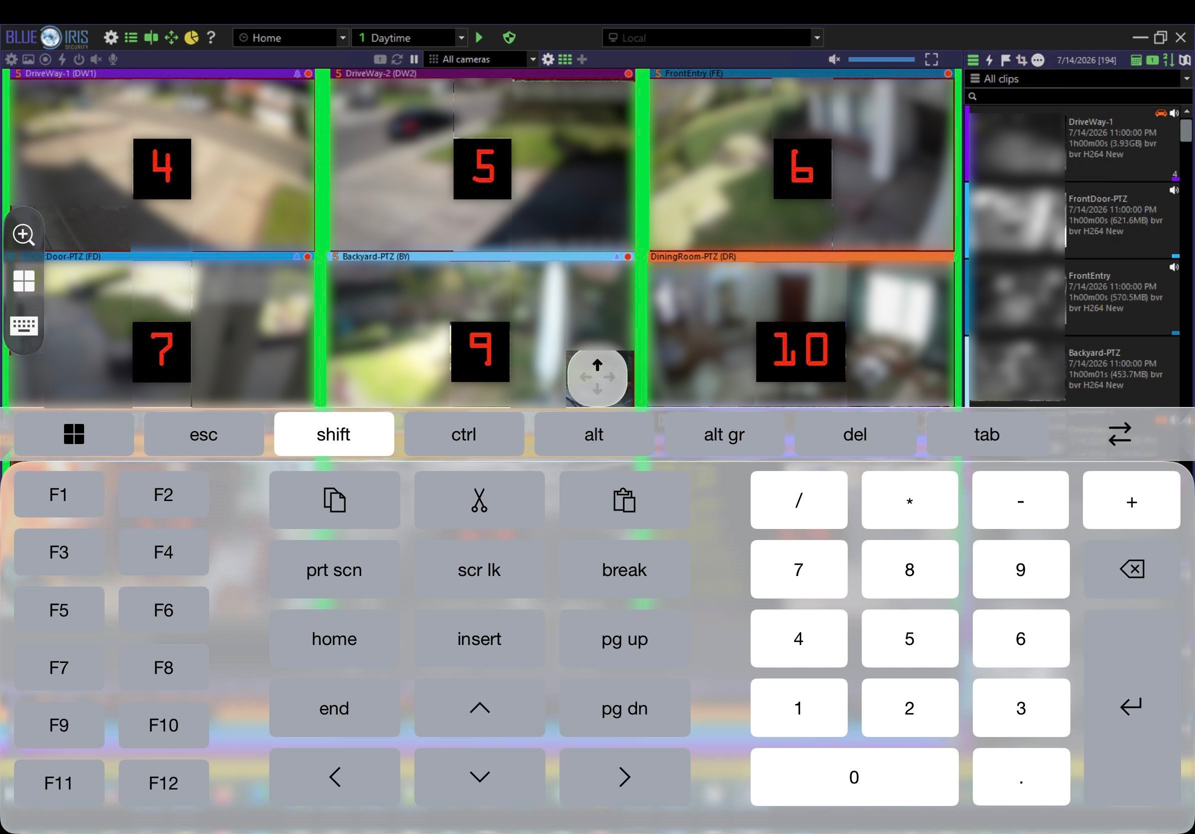

I routinely remote to my Blue Iris server by using an iPad (with Apple Pencil) via the Windows App (Remote Desktop).
To access Blue Iris desktop UI context menus, I can usually simulate a mouse right-click by:
  1. Touching the desired location with the Pencil (or finger)
  2. Touch typing Shift+F10 using the Windows App's on-screen keyboard (see screenshot 1)
However, this does not work in Layout Editor mode. In the BI desktop UI, right-clicking the green layout background normally displays the context menu. But when using the iPad Windows app to Remote Desktop the server, Shift+F10 does not display the Layout Editor context menu. Thus I cannot perform actions like show hidden cameras, hide disabled cameras, etc.

  6. Double-click the shortcut. You should see a green H icon in the system tray. It will show a tooltip when you mouse over it (see screenshot 2).
