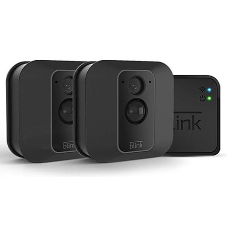

While I have 5442s, I also have some Blink cameras I got for $13 each on sale. Completely wireless, they only record when they detect motion (and even then the motion detection is somewhat limited to horizontal movement) But still, it was $13 and I can cover all my windows in 5 minutes of work because it doesn't use wires. The quality kinda sucks but it serves as a good enough motion alert.
The deal seems to pop back up every few weeks. Usually limit 3 each time. You also need a blink sync module which I got used off ebay for $20.
Link to previous deal: I would set up a deal alert on slickdeals if you're interested (you'll get a notification next time someone posts about the deal
