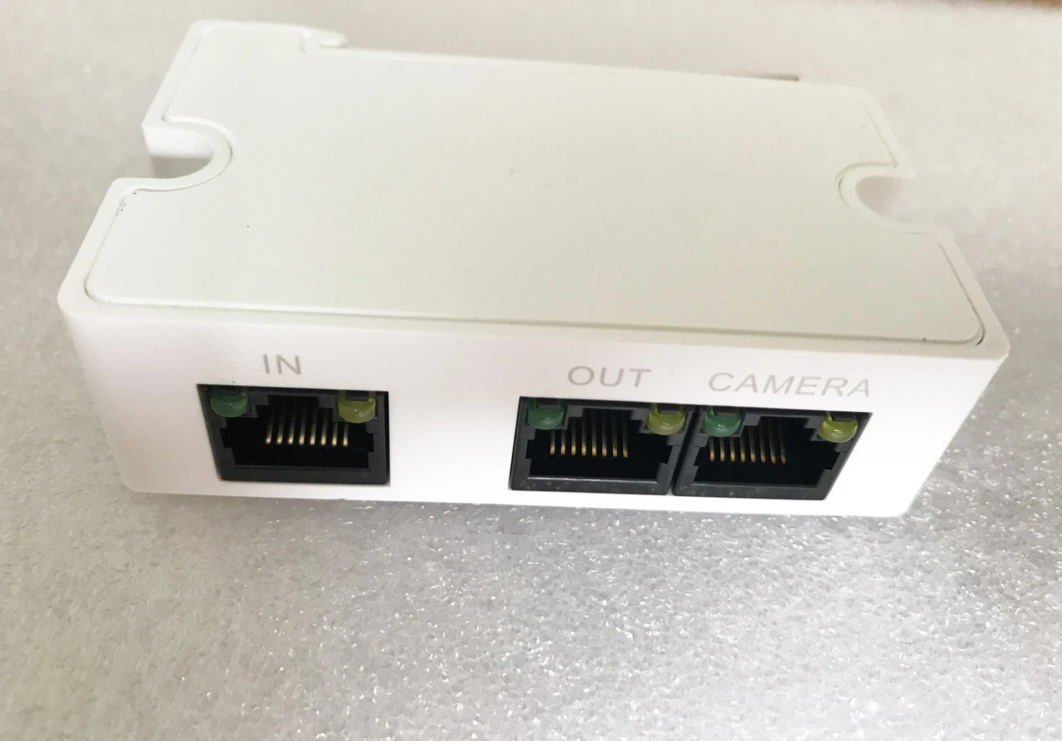

When putting two cameras in one place, not including big PTZ cameras, can you have one Ethernet cable and split the POE and data at the end with something fitting in a small junction box? Or do you need to run a 2nd cable?
These work very well if you do not want to run a 2nd cable...
It's always best to run multiple cables to every location. Each camera should ideally have its own cable the whole run.
If you have power available at the endpoint, though, and a place to put it, you could put a POE Ethernet switch at that end and then run separate shorter cables from there to the cameras mounted in that location.
Cable is cheap. Your labor and the pain in the butt of running it is the real "cost". It's about the same labor to run several cables to a given location as it is to run just one. Spend the money on cable up front and always run more than you think you'll need to every point.
