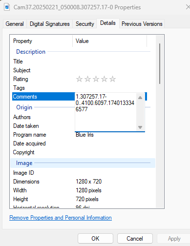

Also, since you are using the API to create Alerts with memos, can you check a few of the JPG files in the Alerts folder and confirm that the Exif metadata contains the expected memo text?
If you need a refresher, see post #10.
Yes to all of your snapshots, with exception to AI confirmation. I don't do AI confirm. Metadata exists
Yes it does. Also in my case all I care about is the memo baked into the alert below 216-R-2806058_K. I attached 2 pics one from the BI directly and one from the UI3

I think this might be a bug (HTTP command not updating the JPG Exif metadata). I'll experiment. If I can confirm, I'll email Ken and ask.
I've confirmed that the memo text is missing from the hi-res JPG's Exif metadata. I've just emailed Ken to inquire if this is a bug.
Reactions: looney2ns
I've confirmed that 5.9.9.28 now updates the JPG's Exif metadata when you use an HTTP interface command like the following:
/admin?camera=FD&trigger&memo=my%20text
under the following conditions:
Camera settings:​
Alert tab > Add to the alerts list > Hi-res JPEG files​
Alert tab > Confirm the alert with AI unchecked​
Results:
  • External alert created in the clips list
  • Alert JPG created in the Alerts folder.
  • JPG’s Exif metadata now contains the memo text.
