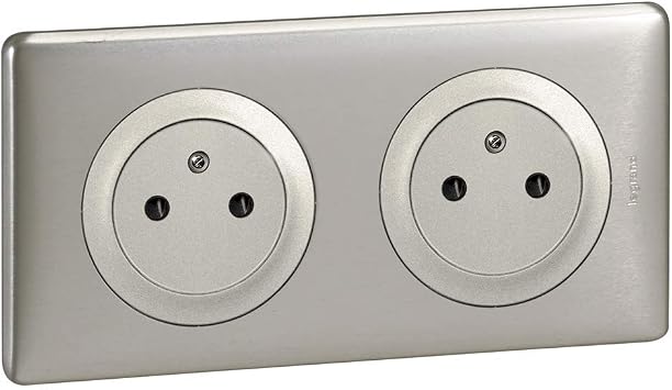

BICK, I love how clean your doorbell button/camera looks! Have you posted anywhere how you made this or is it a store-bought product? You mentioned the Hik covert cam and fisheye lens, but what about the button and frame?
I have bought a legrand Celiane white button and added a sticker , the button is connected to the covert module.
When somebody press it i receive a push on my smartphone and i after i use my VMS and can go back to the recording very easy.
here is a example here :
