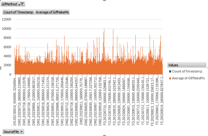

Here a chart showing the make time for 1,122 GIFs from 2023-07-09 to 2023-10-28. The vertical axis is milliseconds. The avg±sdev is 3.2 ±1.1 sec.
