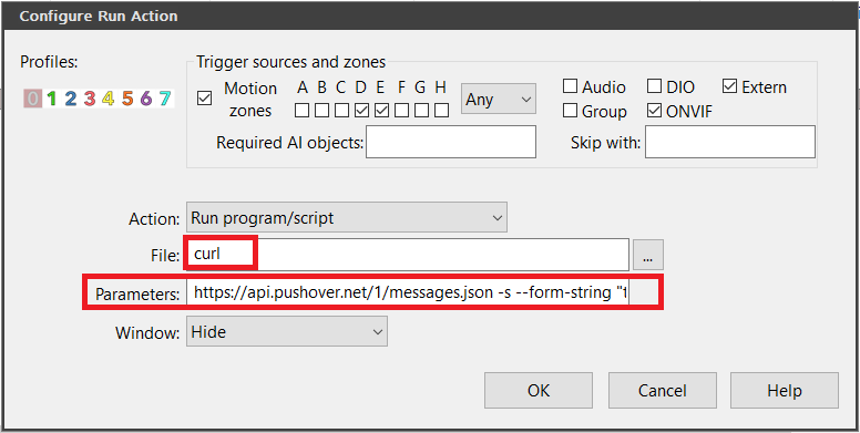

Blue Iris Action setup:
via Camera settings > Alerts tab > 'On alert...' action set

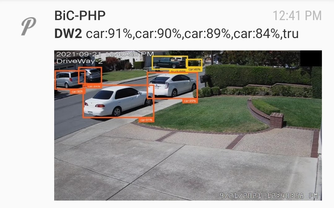

Example 1...
Notification as received in the Pushover App.
Note that this example includes 2 hyperlinks in the message body.

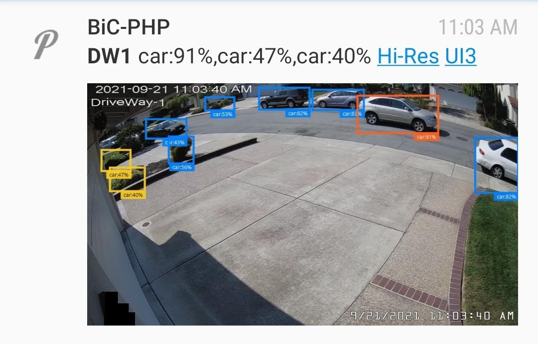

IMPORTANT: The hyperlinks are active only AFTER you touch the notification.

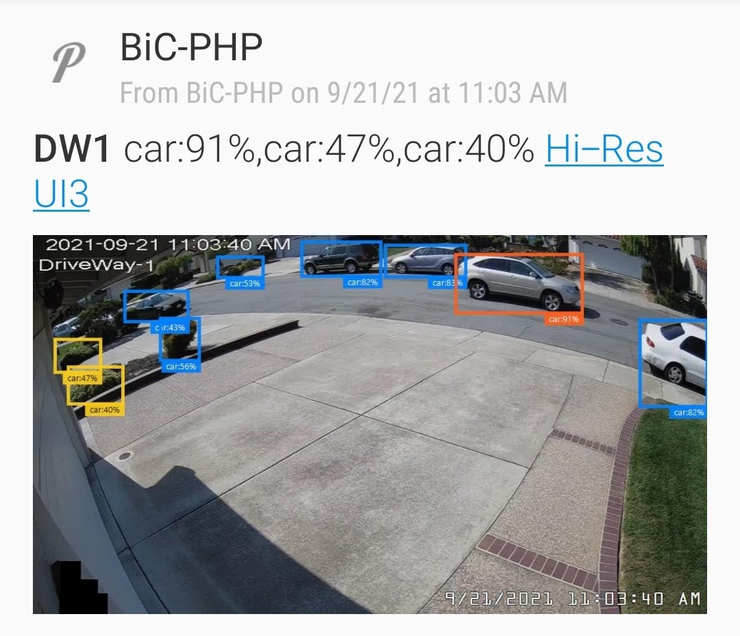

Notification as touched.
  • The 1st hyperlink 'Hi-Res' shows the full-size markup that you can pinch/zoom to read the tiny AI labels.
  • The 2nd hyperlink 'UI3' streams the alert on your device.
Here is the code that you need to enter into the 'Parameters' field for Example 1.
Code:
https://api.pushover.net/1/messages.json -s --form-string "token=YOUR_APP_TOKEN_HERE" --form-string "user=YOUR_USER_KEY_HERE" --form-string "message=<b>&CAM</b> &MEMO <a href='&WAN/alerts/&ALERT_DB?fulljpeg'>Hi-Res</a> <a href='&WAN/ui3.htm?rec=&ALERT_DB'>UI3</a>" --form-string "html=1" --form-string "device=YOUR_PUSHOVER_DEVICE_NAME(S)_HERE" --form-string "sound=YOUR_PUSHOVER_SOUND_HERE" -F "attachment=@D:\BlueIris\Alerts\&ALERT_PATH"

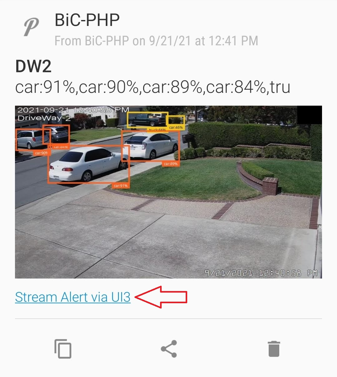

Example 2...
Note that this example includes no hyperlinks in the message body.
Note the hyperlink below the image - it uses 'UI3' to stream the alert on your device.
Here's the code that you need to enter into the 'Parameters' field for Example 2.
Code:
https://api.pushover.net/1/messages.json -s --form-string "token=YOUR_APP_TOKEN_HERE" --form-string "user=YOUR_USER_KEY_HERE" --form-string "message=<b>&CAM</b> &MEMO" --form-string "html=1" --form-string "device=YOUR_PUSHOVER_DEVICE_NAME(S)_HERE" --form-string "sound=YOUR_PUSHOVER_SOUND_HERE" --form-string "url_title=Stream Alert via UI3" --form-string "url=&WAN/ui3.htm?rec=&ALERT_DB&maximize=1" -F "attachment=@D:\BlueIris\Alerts\&ALERT_PATH"

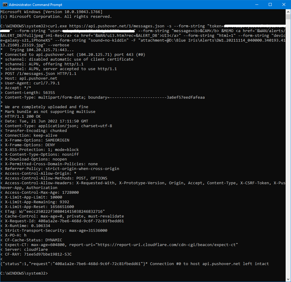

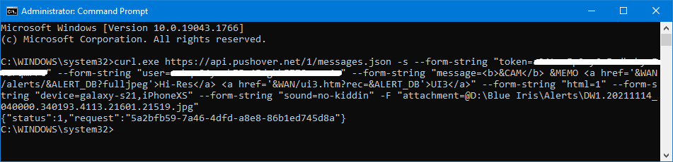

Testing using the Windows Command Prompt
To verify that curl.exe is installed on your system, type curl.exe -V in a cmd.exe window.
To test your API command syntax before using it in a Blue Iris 'Run a program' action, try sending it directly in a cmd.exe window.
curl.exe https://api.pushover.net/1/messages.json YOUR_ARGUMENTS_HERE
Example:
EDIT (6/21/2022): You can also add add argument --verbose to examine details.

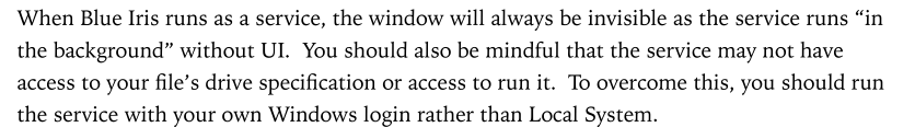

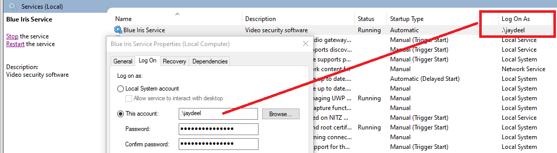

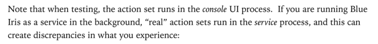

EDIT (1/29/2023) Do not use the Action Set ‘Test’ button (lightning bolt) to test your Pushover ‘Run a Program’ actions. Use real triggers instead, e.g., actually walk in front of the camera... To learn more, read the Help PDF, specifically the section ‘Testing the Action Set’ in the ’Alerts and Actions’ chapter. See also this thread <link>.
Using Blue Iris actions requires that you are not running the Blue Iris service using a LocalSystem account.
To learn more, read the Help PDF, specifically the first section in the Administration chapter.
If you are already running the Blue Service service using a user account, then try these 'tricks':
1. Make sure the macros are resolving when requested from the service <link>, and/or
2. Capture the actual Pushover API command in a *.txt file for inspection <link>.

Example 2...
Note the hyperlink below the image. it uses 'UI3' to stream the alert on your device.
Code:
https://api.pushover.net/1/messages.json -s --form-string "token=YOUR_TOKEN_HERE" --form-string  "user=YOUR_USER_KEY_HERE" --form-string "message=<b>&CAM</b> &MEMO" --form-string "html=1" --form-string "device=YOUR_PUSHOVER_DEVICE_NAME(S)_HERE" --form-string "sound=YOUR_PUSHOVER_SOUND_HERE" --form-string "url_title=Stream Alert via UI3" --form-string "url=&WAN/ui3.htm?rec=&ALERT_DB&maximize=1" -F "attachment=@D:\Blue Iris\Alerts\&ALERT_PATH"

When you are testing the syntax are you using the test button from the 'Action set' dialog?
If so, I think know what's happening. The macros are not resolving.
The reason for this is described in the help pdf.... see this excerpt from the 'Testing the Action Set' section.
To verify, try assigning your curl action to a preset of one your cameras. (This is easier for testing as you don’t need to wait for the camera to trigger.) The action will fail to send a pushover message if you use the test icon in the 'Action set' dialog, but it will work if you execute the camera preset from any Blue Iris application.
To see why this is so, try assigning the following 'Run a program' action to another preset;
File: msg.exe
Parameters: * /TIME:5 DB=&ALERT_DB, PATH=&ALERT_PATH
This run action sends a self-closing popup message to your screen. (You can use other macros if desired.)
When you execute the preset's 'On call' action from 'Action set' dialog, the macros do not resolve.
However, when you execute the preset via a Blue Iris app, the macros do resolve.

Also confirm that you are not running the Blue Iris service on a 'Local System' account.
Using your Windows Login ensures the service can access the local file system (your alert images). Here's the excerpt from the help pdf:
Well, I don't have any immediate results (no alerts just yet), but the likely solution here for fixing my Blue Iris app notifications not coming through was the battery optimization, as it is the only possibility that didn't already meet the criteria. Yes, I had already run through every other checklist item on my own, and knew enough not to run my Blue Iris service under the Local System account (it runs under my admin account).

Can you successfully execute the curl command from a cmd.exe window? It may require starting cmd.exe with administrative rights .
You'll need to replace &ALERT_PATH with an existing *.jpg file in your Alerts folder, like
The other macros (&WAN, etc.) will not resolve to their values, but will not prevent the api command from executing.
If nothing happens, test curl.exe as follows

Well, I have progress to report, but a weird mix of partial successes.
Upon arriving home, when I RDP connected to my B.I server I was greeted with today's update of B.I. to 5.5.5.6, so I went ahead and installed it (I was on 5.5.5.5 previously). I then went to the Alerts, Test tab and miraculously, the Pushover alert worked (even though you had said it might be problematic). Great! OK, how about a "real" walk-through test? Same, and with a photo attached as well! Cool, right? Well almost, as I still have no hyperlinks showing (remember, I am using your "Example 1" parameters, per the first post), and even after opening the notification, I still have no links. Also, even though I am using DeepStack, and the photo shows the box around a person with the percentage of likelihood, the text of the notification is generic in the sense that it only shows "motion detected", so something is still quite off in my installation. Does that give any hints?
Also, even though I thought we may have found the magic sauce to get the official B.I android app notifications working (by disabling the battery optimization for that app), there has been no change there either: I only get notifications if the app is open. Every other setting you suggested was already correct, all notification permissions have been granted, and I have tried the uninstall/re-install routine already. Do you think there is any chance it might have to do with my phone's B.I App access being permanently through an "always-on" OpenVPN connection back to my home router (so during the app setup screens both the WAN and LAN use the same "local" LAN address)?
Looking forward to further hints...

Ok, I just ran your suggested test from the (elevated, admin) command prompt and it worked perfectly, I did get the proper alert in the Pushover app. This of course was with a direct path to a photo in my B.I Alerts folder, as suggested.
What now?
