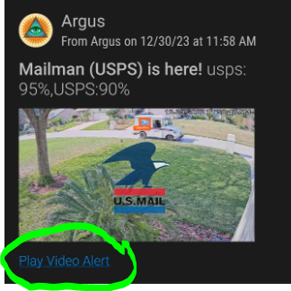

Sometimes when I receive a push notification the link (Play Video Alert) generated does not work. Taking a closer look I can see that the curl script sometimes generates a link with is not valid. When you click on the Play Video Alert link, instead of the video clip playing in UI3, I get an error message that it can't open the link. For some reason the formed string creates a link that is not valid.
When it works correctly the link generated looks like this:
But sometimes it generates a link like this which doesn't work:
Here's my json command:
https: /api.pushover.net/1/messages.json -s --form-string "token=MyToken" --form-string "user=MyUserID" --form-string "message=<b>Mailman (USPS) is here!</b> &MEMO" --form-string "html=1" --form-string "device=MobilePhone" --form-string "sound=bugle" --form-string "url_title=Play Video Alert" --form-string "url=&LAN/ui3.htm?rec=&ALERT_DB&maximize=1" -F "attachment=@E:\BlueIris\Alerts\&ALERT_PATH"
Is this possibly happening because BI is in the middle of processing another alert so by the time the curl command grabs the time stamp and camera ID it's pointing to something different? Is there a work around to guarantee 100% of the time it's correctly grabbing the timestamp and camera ID correctly?
I can replicate the funky URL in a browser by using the following
ui3.htm?rec=&cam=mycam
So I would agree that the likely cause is that macro &ALERT_DB is not resolving.
Recommend that you email Ken and inquire if it’s possible that a race condition is resulting in the unresolved (blank) macro. Perhaps he can code a fix.
As a work arounds, you could try:
  • Inserting a ‘Wait’ action (say 500 msec) before the Curl ‘Run a program’ action.
  • Enabling the ‘Wait for process to complete’ option in the Curl ‘Run a program’ action.
PS - Macro &ALERT_DB is a database record, not a timestamp.
