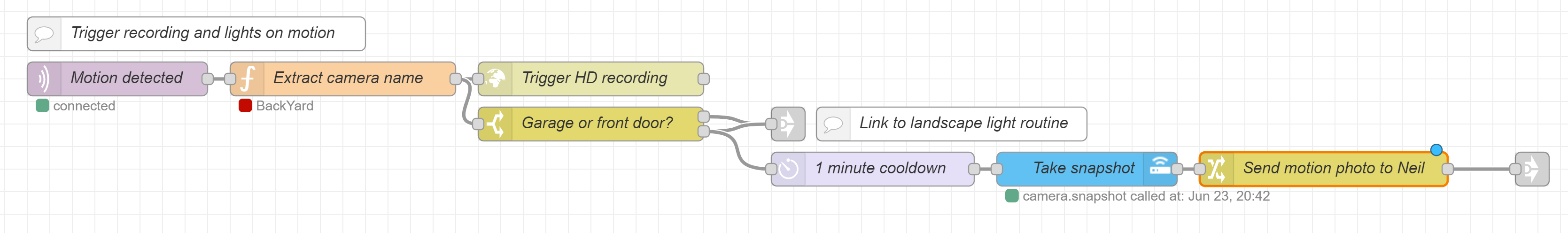

For the image what I do is actually have Home Assistant request a dedicated snapshot from the camera. This gets the image stored locally on my HA web server so I can access it remotely. Alternatively you can reference it directly from the trigger Docker image with some additional configuration, but frankly I found that more hassle than it was worth... and I even wrote the feature specifically because I wanted it!
Picture of the flow. You'll note that I also have HA managing the triggering of the recording by BlueIris, and turning landscape lights on when garage or front door motion is detected:
Here's the function node code, which extracts the camera name and only allows the sequence to proceed if the state is on:

Thanks for sharing the flow. Can you also please share how you "a parsed JSON object" did you use change node to extract basename to send the URL:4242/basename as image with formattedPredictions?
You don't need a change node for it. On the MQTT in node set the output dropdown to "a parsed JSON object". Then basename will be in msg.payload.basename.
