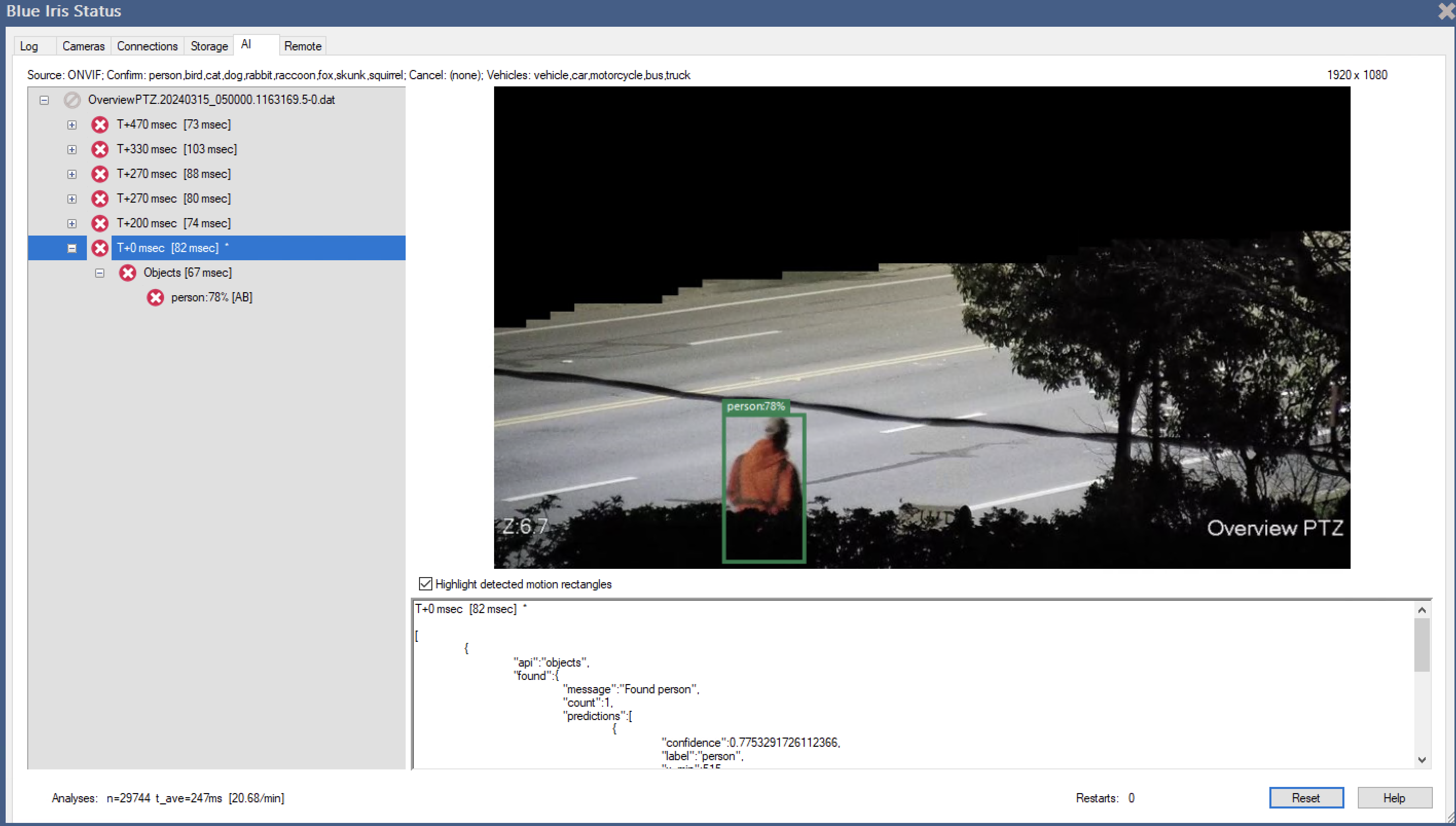

Are you saying the DAT files for these db-confirmed Alerts have no asterisked images when viewed in the Blue Iris DAT Viewer?
See screenshot for OverviewPTZ.20240315_050000.1163169.5-0.dat.
None of the detected objects in this dat > minimum confidence #.
Why would script think it's database confirmed?
(I double-checked in UI3 and this date/time does not appear in my confirmed alertlist. It is on my cancelled alertlist)
This suggests a bug in the script.
if possible, would you mind running the same command adding the -DevMode argument, then PM the resulting alertlist_camera.json file?
Edit: And also the script’s *.csv file.
