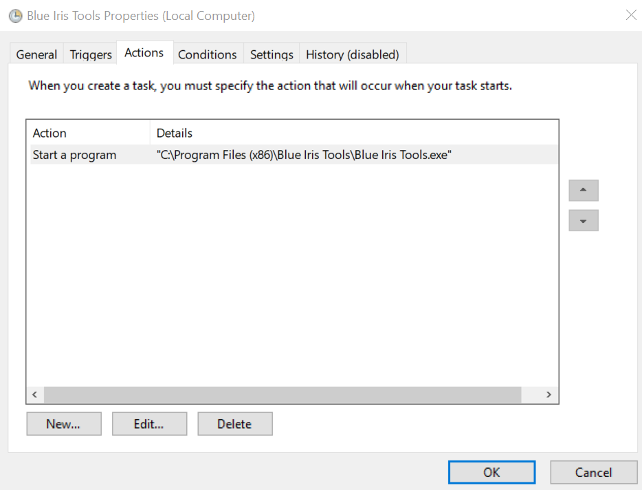

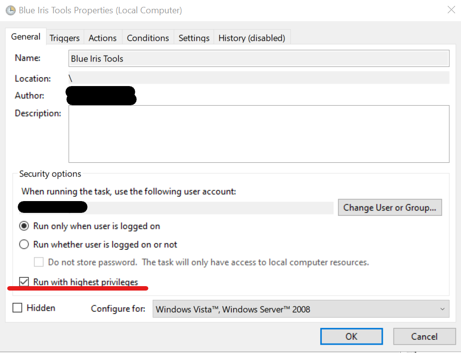

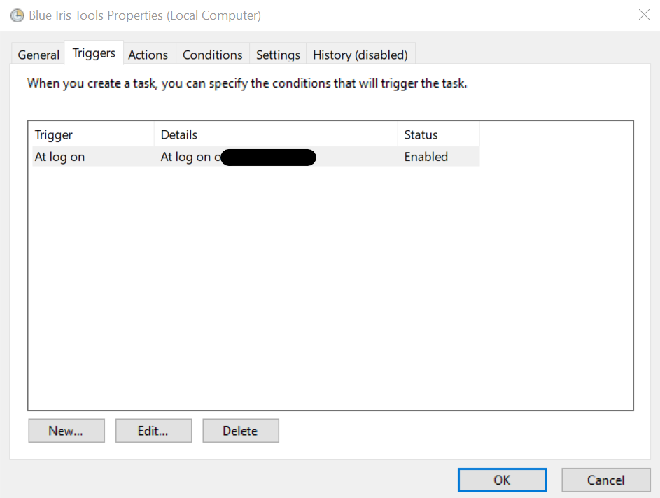

I did what @AngryToast did which is to open up the scheduler and create a task that runs at bootup with elevated privileges as this is exactly the same way I already had Blue Iris set up.
I thought you'd lose the GUI this way. I remember trying this but don't remember why I didn't like this way.
BI Tools will be running as a process but the GUI has been iconified (mimimized to the tray on Startup) in the lower right corner. In Windows10 just click on the "up arrow" then click on the BI Tools icon. You can see the two BIT settings to play with below.
Reactions: pov2 and TonyR
Don't you have to uncheck "Start when Windows Boots" if you start the BIT from task scheduler?
Correct....just showing all the boxes you can play with.
