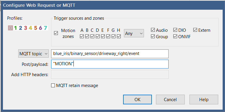

Blue Iris as an MQTT client pushes a message to the MQTT broker with a topic and payload - in this case, my
"driveway_right" camera. Note that the text for the MQTT topic and payload is just something I made up, but it has to
be formatted with slashes as shown (that's not entirely accurate - you could just subscribe to something like "blue_iris" to receive
all events, but you would have no idea which camera or device sent the message.)
Camera Settings--> Trigger--> Immediate actions...--> Web request or MQTT:

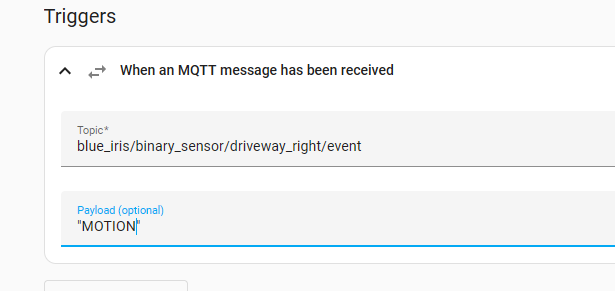

And similar to the Homeseer 3 screenshot above, Home Assistant provides something called an "Automation" which has Triggers, Conditions, and Actions.
A "Trigger" can be an MQTT message:

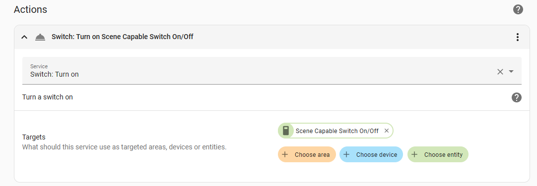

and then an "Action" (turn on a Z-Wave switch in this case):
It can get complicated pretty quickly if you want, with various conditions, multiple areas, devices, and entities, but hopefully this helps.
