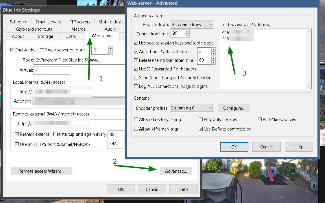

in order to make it work with jpeg from bvr, I needed to add the ip of the machine running the script to the setting -> web server -> advanced
with ^ prefix so no password is required (at least on my computer it didn't work until added)
example:
^192.168.1.50

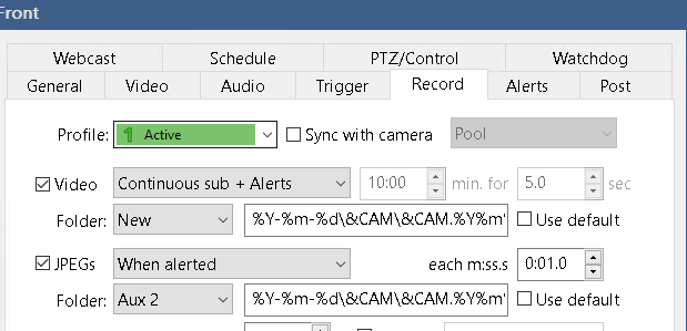

But my issue is with DAT extract, my export location for bvr & alerts is with some sub folders to make it easier for windows to browse...
the extract works but the create gif command is searching in another folder (without the sub folders) for the jpgs...
my Video "special" path is : (D:\Blueiris\New) + %Y-%m-%d\&CAM\&CAM.%Y%m%d_%H%M%S (example: "D:\BlueIris\New\2023-10-20\Front\Front.20231020_160000.bvr")
my Alerts "special" path is : (D:\Blueiris\Alert) + %Y-%m-%d\&CAM\&CAM.%Y%m%d_%H%M%S (example: "D:\BlueIris\Alerts\2023-10-20\Front\Front.20231020_142356.289015.3-1.dat")

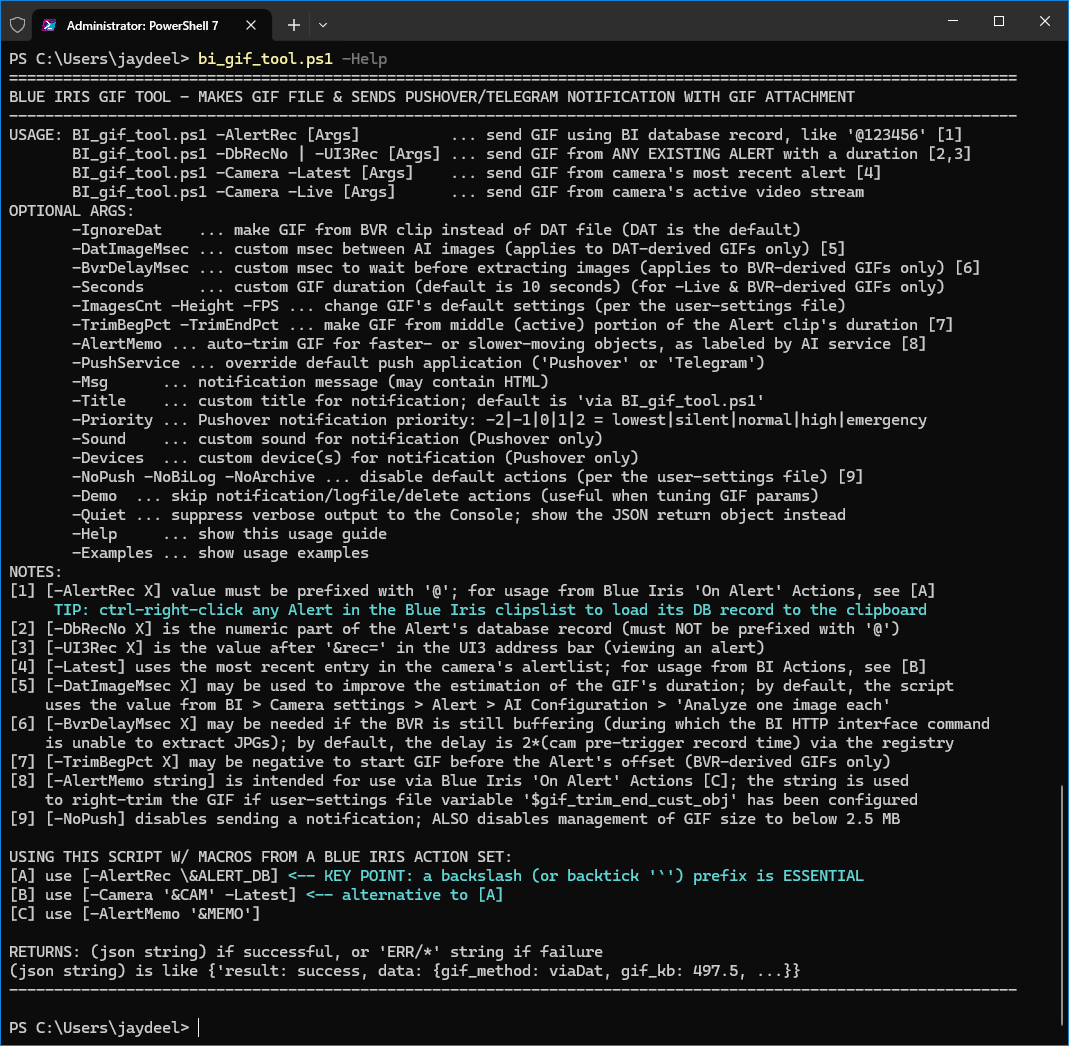

Script updated to V2. see post #1 to download the file

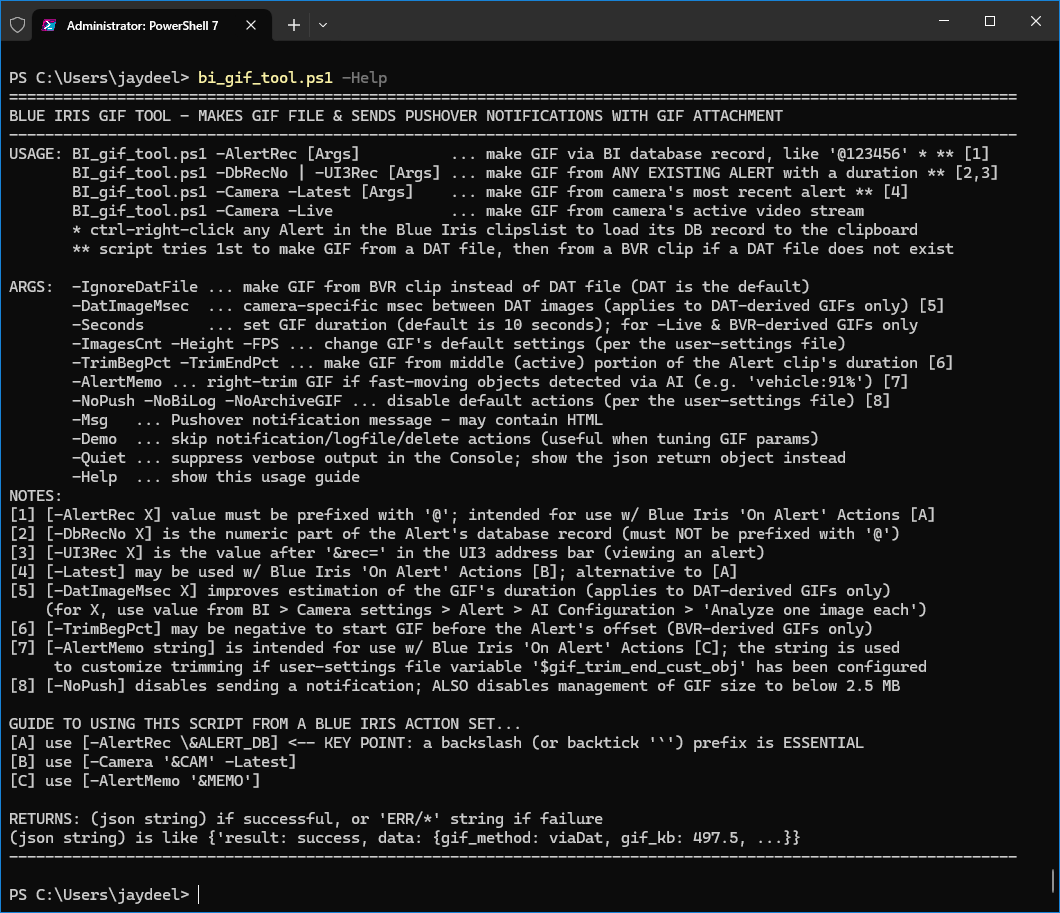

Key features of this new version are:
  • An improved usage guide (-Help argument, see screenshot #1).
  • Added argument -Latest to make GIF from a camera's most recent alert.
  • Eliminated the delay when using the -Live argument
  • Improved support for BVR-derived GIFs (for users that don't wish to create DAT files)
    • script now supports multiple Blue Iris 'New' folders
    • script now supports the use of non-default folder naming patterns in Camera settings > Record > Video (ADDED: 3/21/2024)
    • argument -TrimBegPct may be negative to include pre-trigger images in the GIF
  • Improved support for DAT-derived GIFs
    • added argument -DatImageMsec to improve GIF duration estimates
    • arguments -TrimBegPct & -TrimEndPct now ALSO work for these GIFs (by skipping the the extraction of an appropriate number of JPGs from the DAT file)

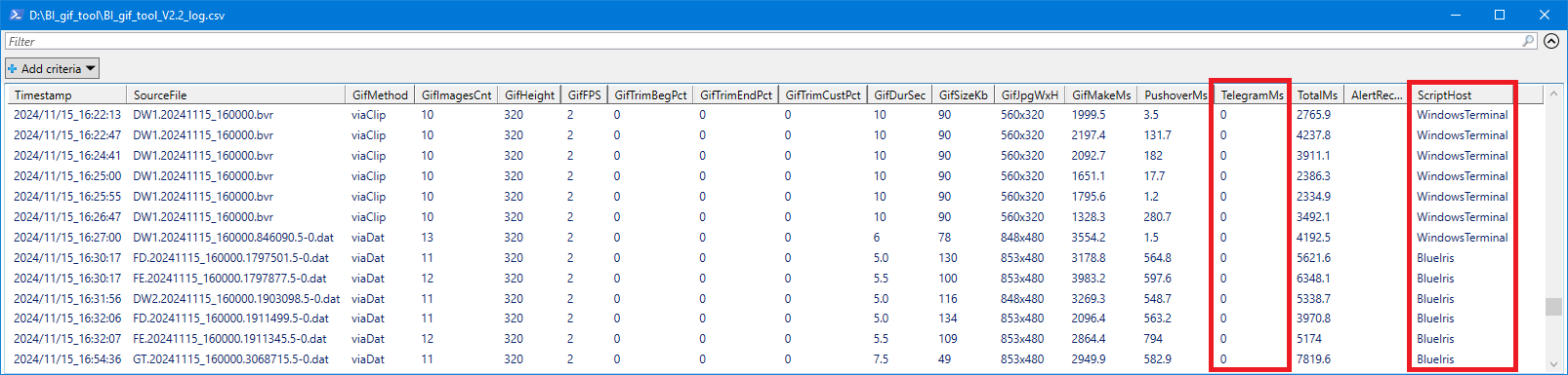

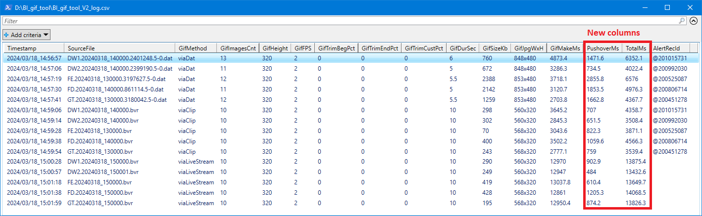

  • Added 2 columns PushoverMs and TotalMs to the script's performance log (see screenshot #2)
Screenshot #1 - shows improved usage guide
Screenshot #2 - shows the new columns in the the script's performance csv file

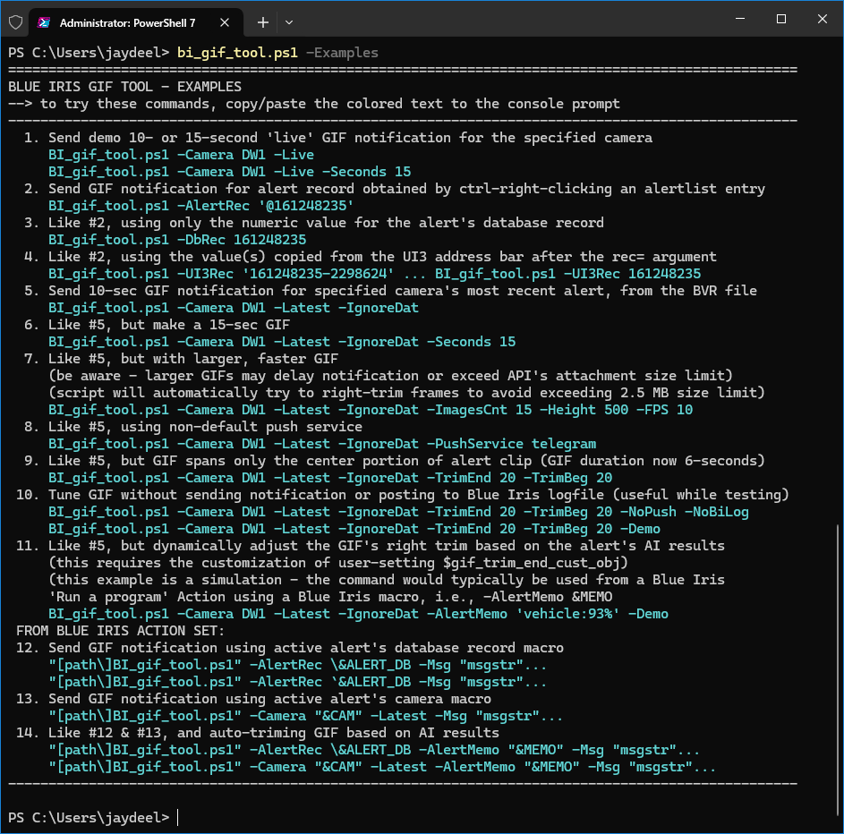

V2 usage examples...
Make and send a 'Live' GIF from a camera
bi_gif_tool.ps1 -Camera "DW1" -Live -Seconds 5
Note: the default duration without the -Seconds argument is 10 seconds
Make and send a GIF from a DAT file (if it exists), or a BVR file (if the DAT file does not exist)
bi_gif_tool.ps1 -Camera "DW1" -Latest
Force a GIF to be derived from the BVR clip
bi_gif_tool.ps1 -Camera "DW1" -Latest -IgnoreDatFile
Add pre-trigger images to a BVR-derived GIF
bi_gif_tool.ps1 -Camera "DW1" -Latest -IgnoreDatFile -TrimBegPct -50
How this works... the script extracts images from the BVR file before the alert's offset. the number of images is calculated as a percentage of the duration of the GIF (10 seconds, by default).

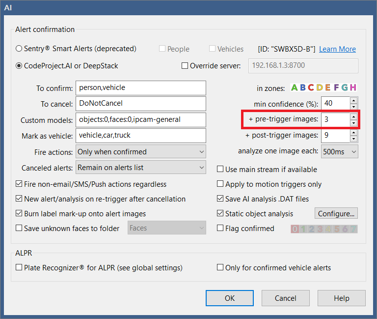

Add pre-trigger images to a DAT-derived GIF
Edit the camera's settings... Camera settings > Alerts > AI configuration > '+ pre-tre-trigger images'
Trim 2 images from both ends of a DAT-derived GIF, where the DAT file contains 10 images
bi_gif_tool.ps1 -Camera "DW1" -Latest -TrimBegPct 20 -TrimEndPct 20
The resulting GIF should contain 6 images
Reactions: jrbeddow

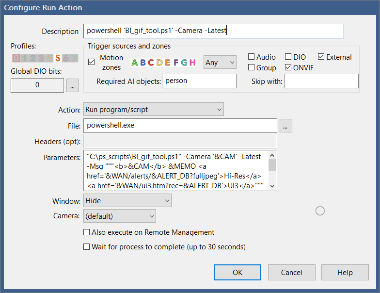

V2 Blue Iris Alert Action Set examples
This is the 'Run a program' Action 'Parameters' string that I'm currently using for most of my cameras...
Code:
"C:\ps_scripts\BI_gif_tool.ps1" -Camera '&CAM' -Latest -Msg """<b>&CAM</b> &MEMO <a href='&WAN/alerts/&ALERT_DB?fulljpeg'>Hi-Res</a> <a href='&WAN/ui3.htm?rec=&ALERT_DB'>UI3</a>""" -Priority 2 -FPS 2 -Height 320
This is the 'Run a program' Action 'Parameters' string that I'm currently using for my driveway cameras... It adds the -AlertMemo argument for custom trimming based on AI labels.
Code:
"C:\ps_scripts\BI_gif_tool.ps1" -Camera '&CAM' -Latest -AlertMemo '&MEMO' -Msg """<b>&CAM</b> &MEMO <a href='&WAN/alerts/&ALERT_DB?fulljpeg'>Hi-Res</a> <a href='&WAN/ui3.htm?rec=&ALERT_DB'>UI3</a>""" -Priority 2 -FPS 2 -Height 320
For example:

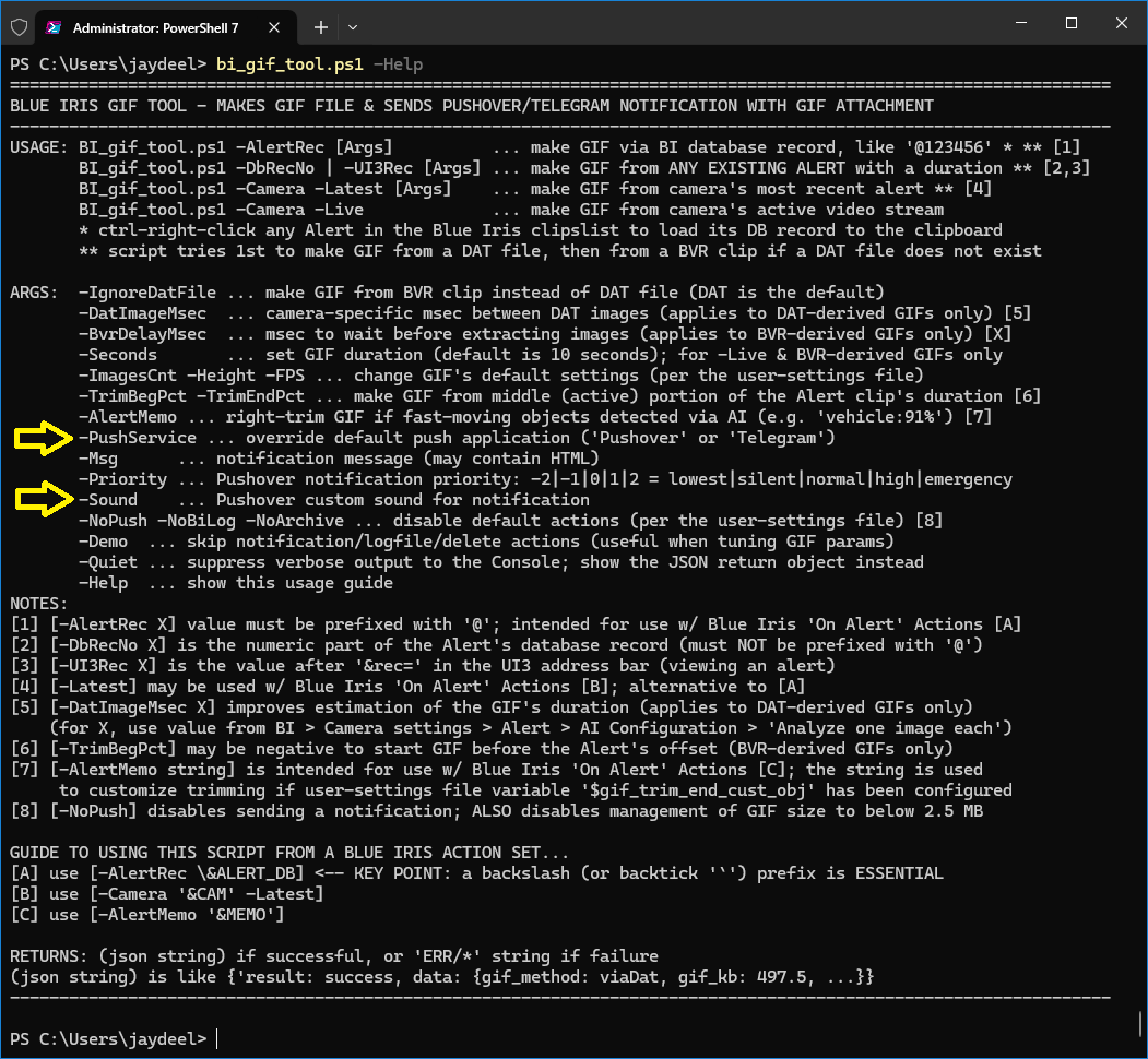

Script updated to V2.1. see post #1 to download the zip file.
  • BREAKING CHANGE: must replace old user-settings file
  • NEW: script now supports Telegram Bot notifications (alternative to Pushover);
  • NEW: added argument -PushService ('Pushover' or 'Telegram') to support on-demand service selection (case-insensitive)
  • NEW: added argument -Sound ('Pushover' only) to support on-demand service selection
  • NEW: script can now make GIFs via BI Clipboard clips (or Alerts created via Clipboard clips)
  • FIXED: script now handles DAT files with JPG images stored oldest to newest; effective BI 5.9.4.11+
  • IMPROVED: DAT extraction more efficient (gets BI version from registry instead of JSON call)
  • IMPROVED: -Live argument now supports the use of non-default folder naming patterns in Camera settings > Record > Video

Performance results...
I'm routinely seeing GIF make times of ~4 sec for DAT files containing 10-13 JPG images.
This chart also shows Pushover notification process times.
Telegram notifications appear to be 1+ second slower than Pushover notifications (while this is a smaller data set than the chart above, I've observed this in other testing as well).
Updated usage guide...

first of all, Thank You! amazing work.
example:
^192.168.1.50
First time user of this PS tool and want to say great work Jaydeel, I'm looking forward to getting GIF alerts. (With the recent Android alerting inconsistencies I'm looking to move over to Pushover.)
General setup and configuration was a breeze, however I hit a snag with getting the images from BVR files. (No img files would get created locally by the PS script.) I referenced LazySecurity247's post above because that was the only thing that worked for me.
Since we provide BI user credentials in the config file, could we use those to authenticate for the BVR image retrieval?
Thanks.
Script updated to V2.2. see post #1 to download the zip file.
  • ADDED: new argument -Examples to provide the user with easy-to-try example commands
  • ADDED: new argument -Devices to support custom device(s) for notifications (Pushover only); comma-delimited
  • ADDED: new column 'ScriptHost' to script's CSV log file
  • ADDED: user setting '$append_performance_tag_details_flg' to hide default performance details notification tag
  • ADDED: user setting '$jpg_images_from_substream_flg' to enable extracting JPGs from the BVR default-stream
  • ADDED: user setting '$jpg_images_match_gif_height_flg' to enable extracting full-sized JPGs from BVR files
  • CHANGED: script can now use BI credentials to create GIFs using JPG files extracted from BVR files
  • CHANGED: removed user-setting $bi_alerts_folder_path; script now retrieves the setting from the Windows registry
  • CHANGED: removed user-setting $bi_webserver; script now retrieves the setting from the Windows registry
  • CHANGED: removed user-setting $dat_image_interval_msec; script now retrieves the setting from the Windows registry
  • CHANGED: script now validates user-setting $bi_new_folder_paths against folders in the BI settings Storage tab

Why you might want to use this update:
  1. You want to avoid using using an entry like ^192.168.1.* in Blue Iris Settings > 'Web server' > Advanced > 'Limit access by IP address'.

Updated usage guide:
NEW examples guide:
New columns in the the script's performance csv file (since V2.0)
