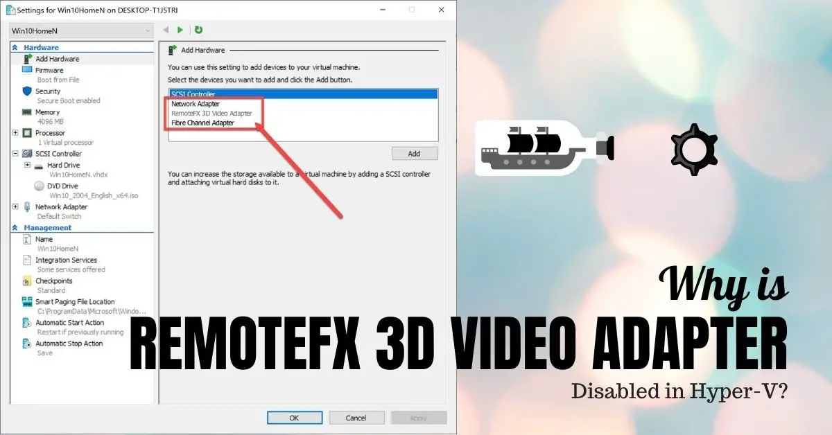

This is just not working on my win 10 pro even after enabling the Remotefx option and rebooting
Add-VMRemoteFX3dVideoAdapter -VMName PVE3
WARNING: We no longer support the RemoteFX 3D video adapter. If you are still using this adapter, you may become vulnerable to security risks. Learn more (osoft.com/fwlink/?linkid=2131976)
Add-VMRemoteFX3dVideoAdapter : Hyper-V was unable to find WMI object, Synthetic 3D Video Pool, to retrieve necessary information for this operation.
At line:1 char:1
  • Add-VMRemoteFX3dVideoAdapter -VMName PVE3
+ CategoryInfo : ObjectNotFound: :)) [Add-VMRemoteFx3dVideoAdapter], VirtualizationException
+ FullyQualifiedErrorId : ObjectNotFound,Microsoft.HyperV.PowerShell.Commands.AddVMRemoteFX3dVideoAdapter
I believe this article refers to a windows vm and not linux lxc container guest on a windows host
