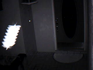

yes, I see, but note that during the day even this cheap Foscam gives me 30fps
it's during the night that it falls to max 10fps
and even if I still have 10fps, shooting times are so looong that flying animals seem ghosts (like star trails)
so the bottle-neck cannot be the switch, cable, etc that are the same ...
here a sample

urgh!
I just noticed my posts are off-topic
I'm speaking of another kind of artifact
so feel free move them elsewhere or delete them
